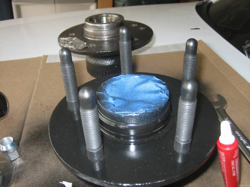

i started my big brake upgrade today. caliper is a 2005 340mm 6 piston and the rotors are 340mm 2 piece lightweight rotors from racing brake. they weigh in at 17 lbs!!!!
so you have to trim the dust shield and thats it!! bolts right on.
thanx to jimmyskullz,lantanatx for all the legwork, the fotos , the ebay auctions that allowed me to run this setup. btw if you stay with the 340mm you can run 17" rims!! the bigger 360mm rotors req. at least an 18" rim. the rotors arent cheap but almost half the cost of the oem rotors for the slk55 and lighter. WINNING! as i finish everything up ill post more pics

the rotors are built by r/b. e/c is a distributor for them. my rotors are the c32 rotors which r/b builds to 340mm specs to allow the leading edge of the caliper to contact the outside edge. happens the slk55 calipers are 340mm! so its a perfect fit.
they will also be building a matching 2 piece rotor for the rears but lead time is 8 to 10 weeks and i just bought a set of oem slk55 rotors for the rear so ill use them.
yes the dust shields are on the backside of the rotor. less than a 3" wide piece was cut off to allow the huge caliper to sit on the mounts. took less than 5 minutes to zip it off with a cutoff tool

If you could post part numbers, and suppliers for the calipers and rotors, that would be great.
Something like this would finish off your install:
They are available from Azevedo Motorsports online.
Yes, those nuts are incorrect. FedEx has happily spent the last week moving the correct nuts around upper state NY for an extended visit. They should be here Friday.
