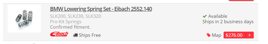

Old Jun 27, 2019 | 07:15 PM
Default Re: Front Coil Springs??
Originally Posted by Tbirdtony
onehundred80,
I checked out RockAuto and they don't carry new coil springs for the Crossfire or Mercedes 320SLK so I guess I'll order new springs from NeedsWings.
FCPEuro has a lowering set :
Old Jun 28, 2019 | 06:38 AM
Tbirdtony's Avatar
Joined: Jun 2018
Posts: 134
From: Beaver, PA
ala_xfire,
Thanks for the information but I am not interested in lowering my Crossfire. Standard ride height is fine with me.
