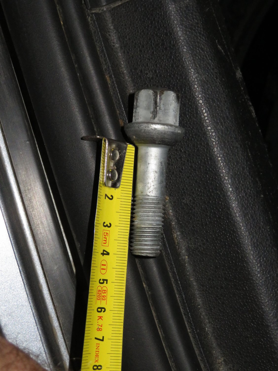

Default Re: Who Needs a Spare Tire for Their Crossfire?
Originally Posted by JBRDH
not knowing which ones id need, i left them in the spare... from what ive seen...it looks like the longer ones that are stock on the xfire will work wiht this spare...
JBRDH, Just whenever you get the chance would you measure the length of the shaft on one of the bolts in your "temporary" spare wheel? (The shaft is BOTH the threaded & non-threaded section that is "straight", and located beneath the head & the flange)
BTW, OE Crossfire lug bolts are M12-1.50, 22.5mm Ball seat flange, 39.4mm shaft, 17mm hex head

just ran to the garage on this cold WI night... to get YOU a pic.. :-)

JBRDH, your fingers are touching the head of the bolt, the wide part below that is the Ball seat flange, and what I'd like to know is the length of THE REST of the bolt, the long, skinny STRAIGHT portion both threaded and unthreaded.

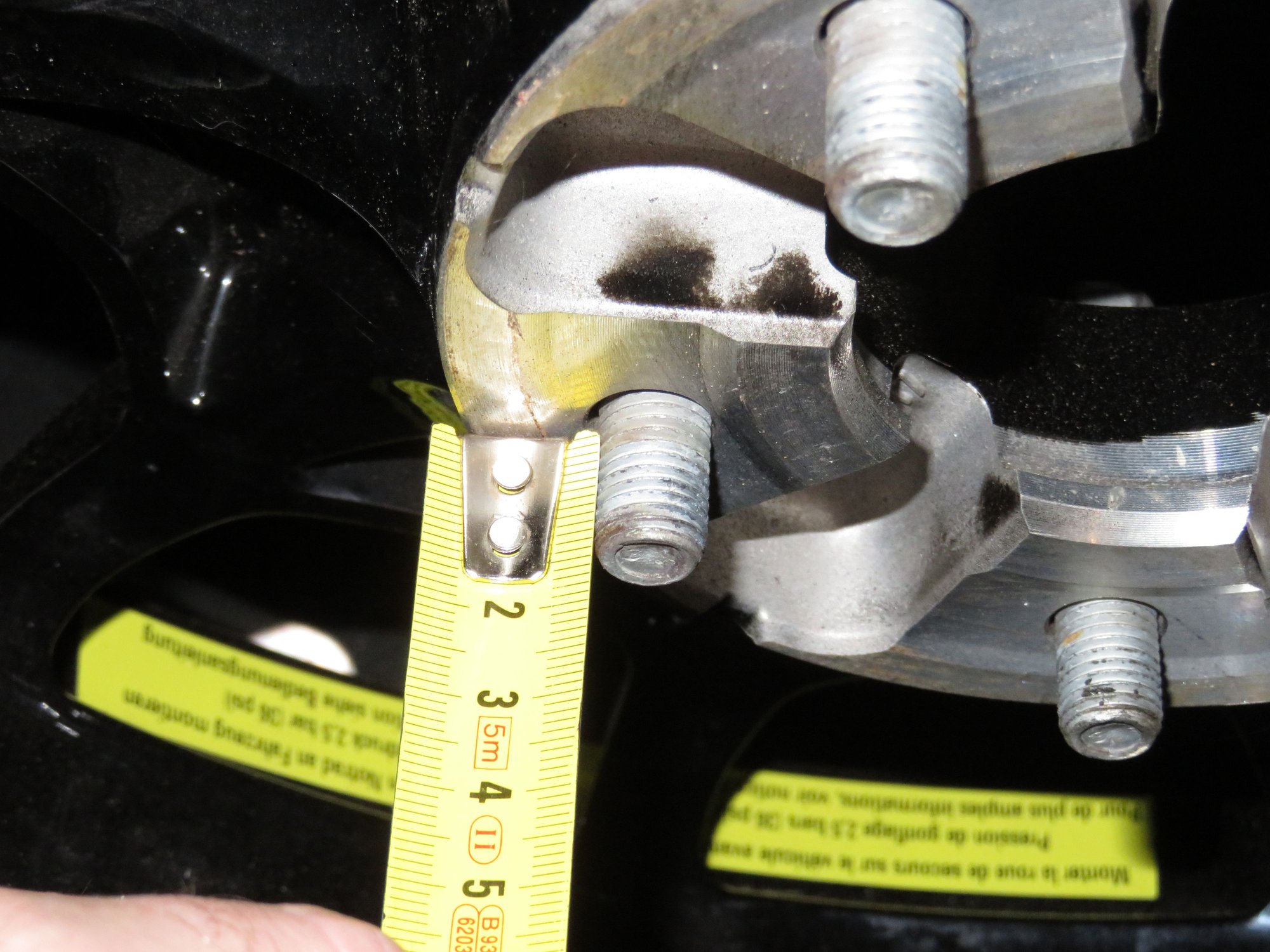

they are approx 40mm long... and this shows how far they stick through the wheel... these may be the oem CF bolts... the LR wheel on mine was replaced just prior to me taking posession... the original cracked wheel was given to me.. with the bolts... I think I just put these in this before trunking it...

Your memory serves you well. I concur with your findings. Thank you BTW, for going out of your way to check it out.

This Mercedes spare uses the same lug bolts as the stock Crossfire wheels.
They both have the exact same thickness at the mounting flange.
