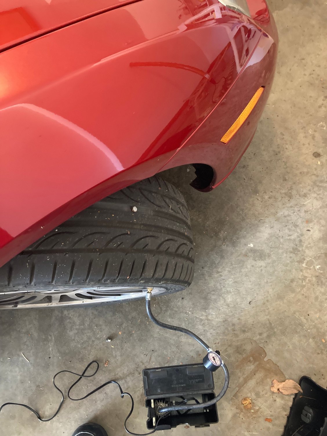

In 110,000 miles of Crossfire driving, only ONCE have I had a tire go out such that someone had to come and rescue me. Twice now, Iv'e had leaks I had to deal with - one was just last night, I picked up a screw. I had my tire fixed in under five minutes without taking it off the car. Here is how I did it. I'd been to the store and noticed the car was 'off'. I found 12 pounds of air in the front right tire. Much less air and the tire would have come off the wheel - and I'd have been STUCK.
Anyway, in this case, like many, step one was to pump 34 pounds into the tire to keep it on the wheel so I COULD fix it. Leave the air compressor attached to the tire - if air starts escaping in later steps, you can just turn the pump back on and keep the tire reasonably inflated.
Step two was to park the car with the wheel all the way to right or left, then jack the car up and rotate the tire so that you can get to the object. Then, I let the tire back down on pavement so I can work on it without it moving. (Alternatively, you can leave the car jacked up, but I don't want the wheel/tire turning as I try to work on it.)

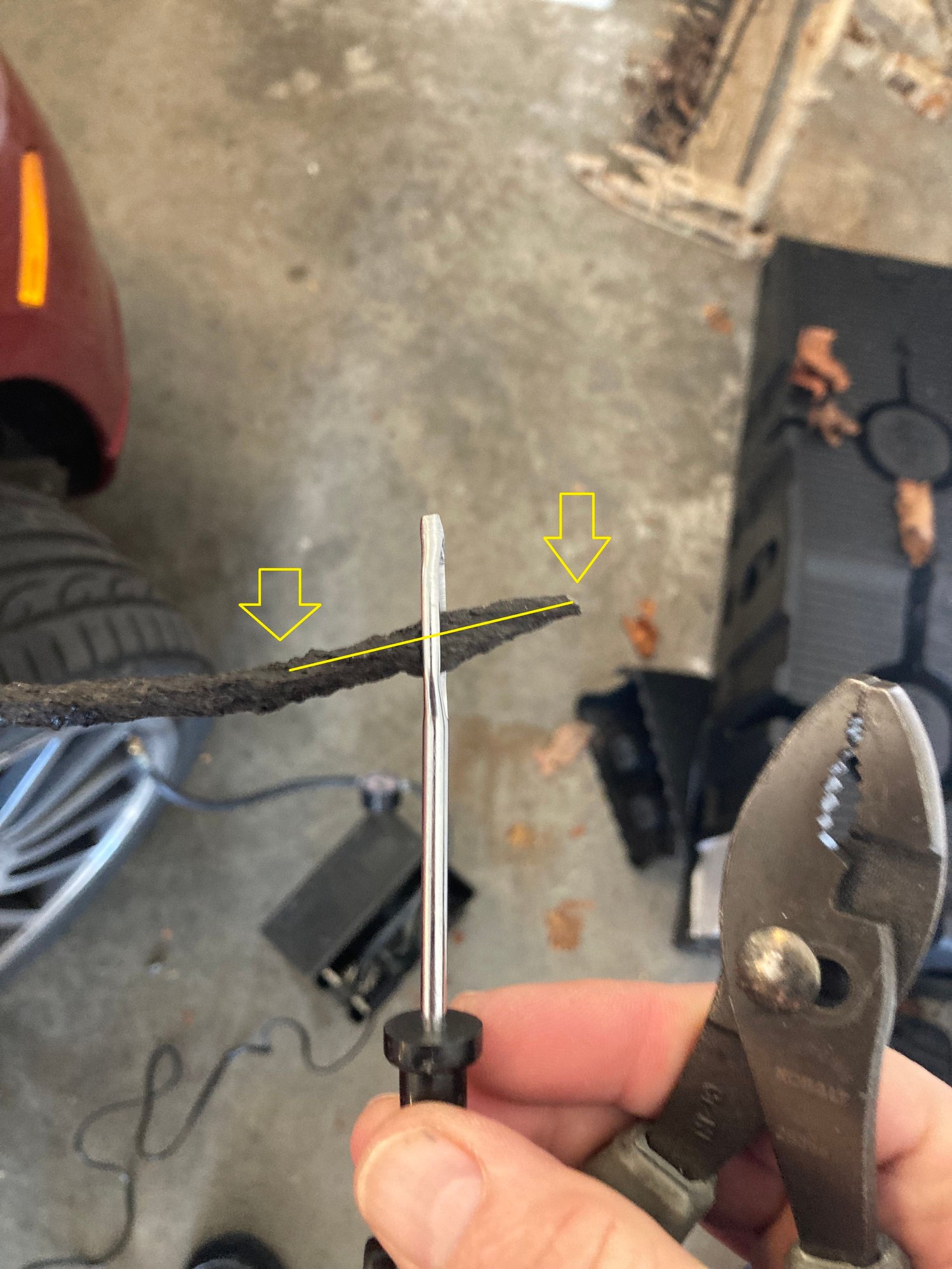

Step three, I grab a "tire worm" and insert it only about 1 1/2 inches into the tool. (I will get to the yellow arrows in a bit...)
Step four is to yank out the object using either 6-8 inch diagonal cutters or conventional pliers (the dikes will enable you to get a better grip and use leverage to left the object out - regular pliers work for objects that don't fight you very much). You now may have a lot of air escaping, if so, turn the air compressor on so you need not hurry at the next steps - you do NOT want the air to all escape, as the tire will separate from the wheel, and you won't be able to fix this yourself. (Alternatively, just leave the car jacked up so there is no weight on the tire - it won'[t separate if there is no stress of the weight of the car on the tire/wheel).
fff

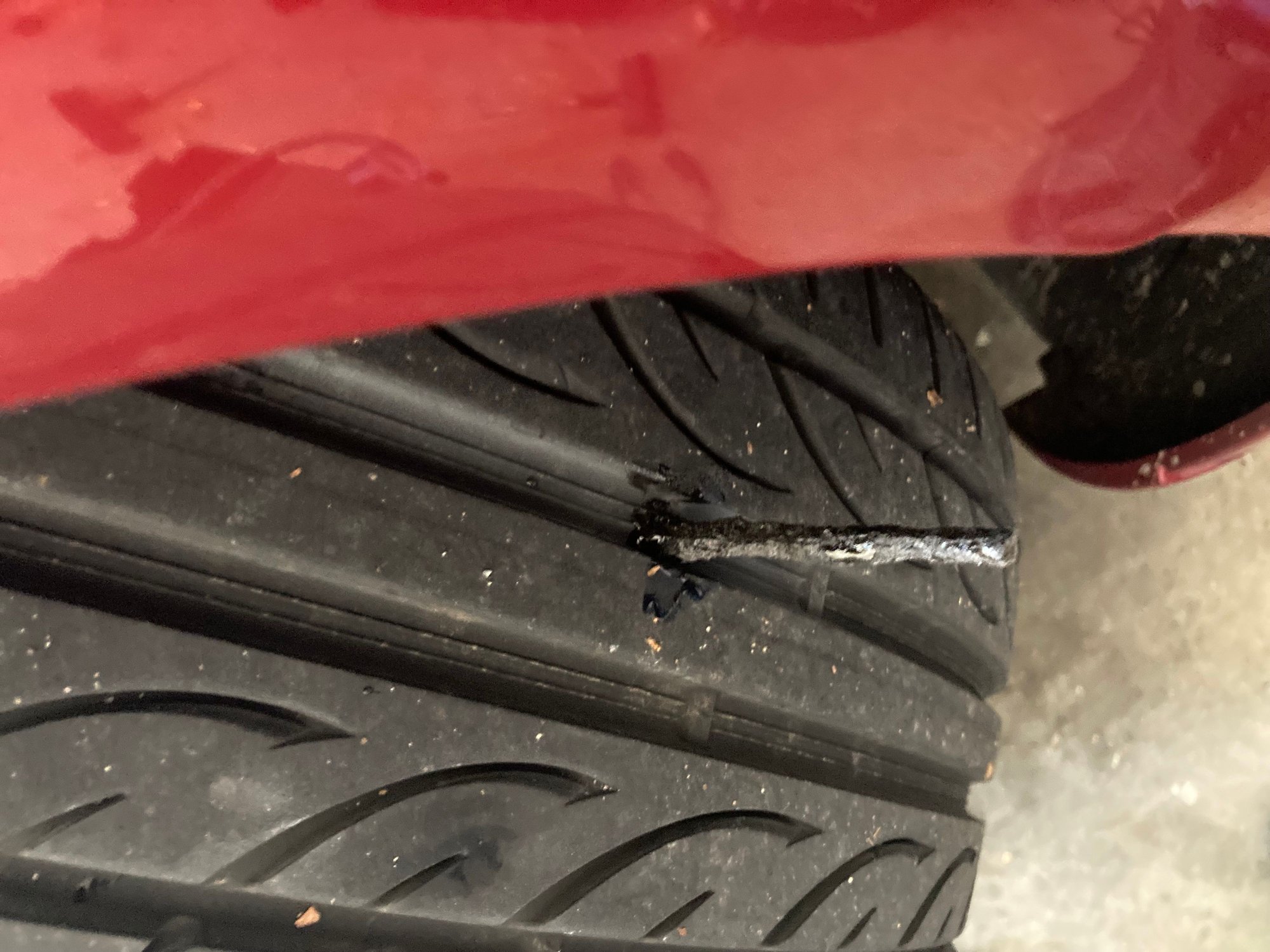

Step five, coat the plug (worm, as I call it) with tire/rubber cement from arrow to arrow in the photo. Now, jam the tool into the hole in the tire and yank it back out. If the worm is WAY in the tire, I try to pull it back out so I am sure the coated part of the plug is in the hole, forcing the cement to seal the hole (if the object was really small-diameter, the size of the plug will be enough to plug the hole anyway). I give it a few minutes for any cement on the outside to set up, then use the diagonal cutters to cut off excess tire plug pretty much flush with the surface of the tire. Waiting means you don't get tire cement on the dikes, which is hard to remove from them if it sets up after it contacts the dikes.
666
Pump tire to 32/33 pounds and you can drive on. I always check tire pressure after a few hours - if it is leaking (only happened to me one time) you can jam a second 'worm' in beside the one you just put in - that should plug it! But again, I've sealed two Crossfire tires, probably five lawn mower tires and maybe four or five truck tires and only had to do that once.
