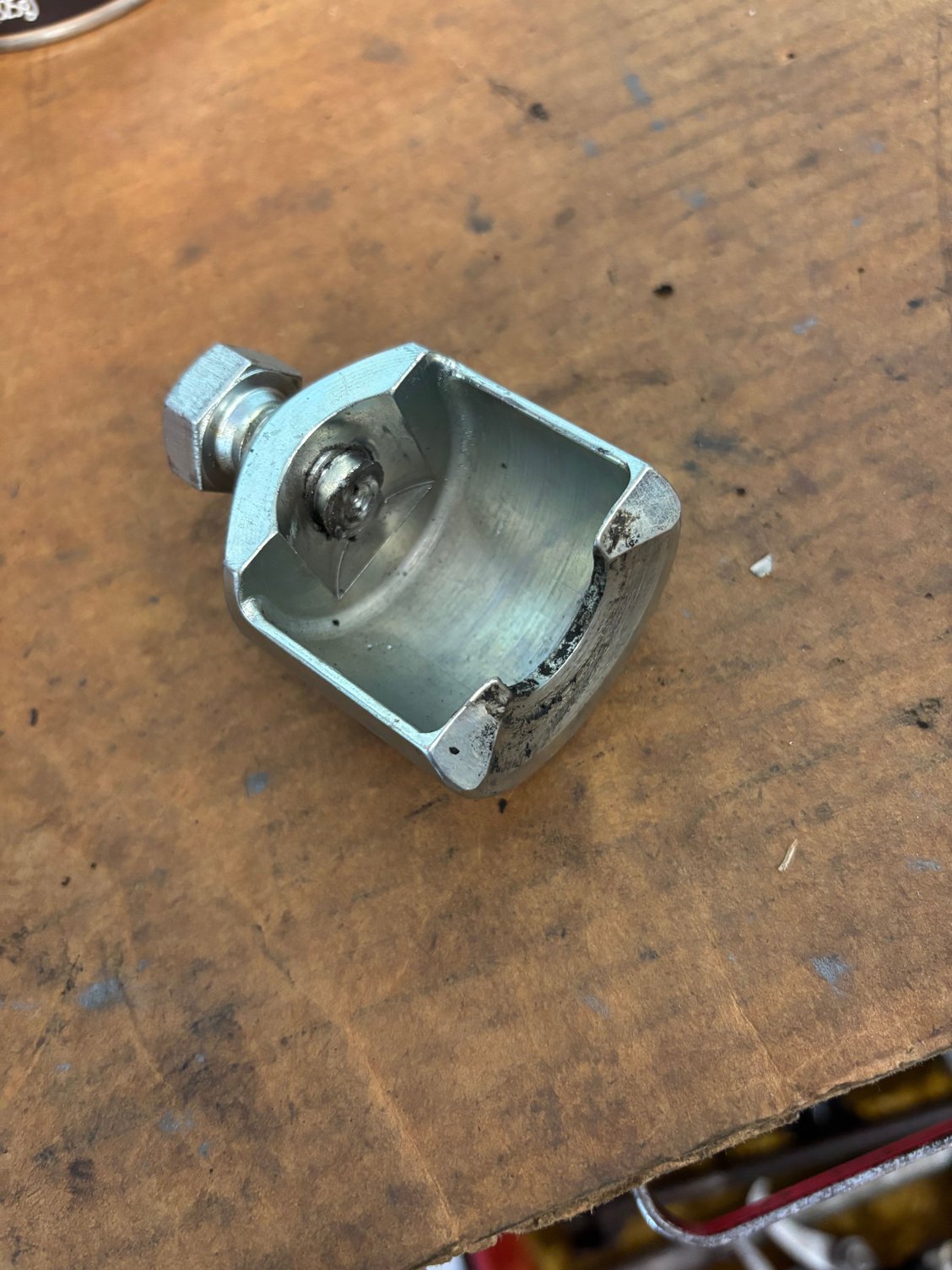

Bkoz412 get yourself one of these. You can use a man helper on a breaker bar, or impact wrench to bust the ball joint open:
