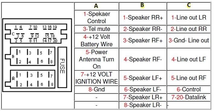

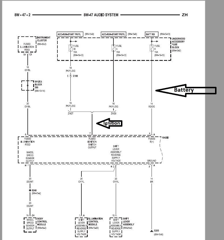

If you slide the radio out, you can access the radio's battery and ignition wires back there.
Just tap into those, as per their directions. They are already fused, I would not worry about adding more fuses.
The connectors are shown here:

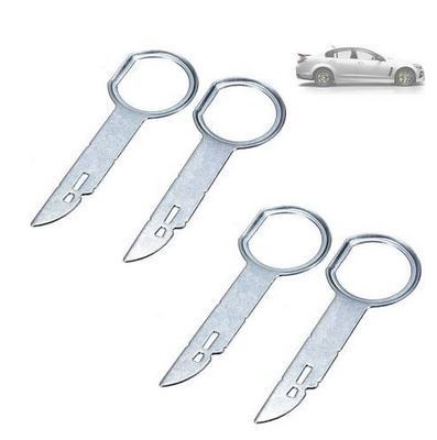

For the Factory radio, you need the tools to pull it out, I got them at Walmart, butthat was six years ago. Just get some that look like this, they are known as "VW" radio tools, but I dont know why:

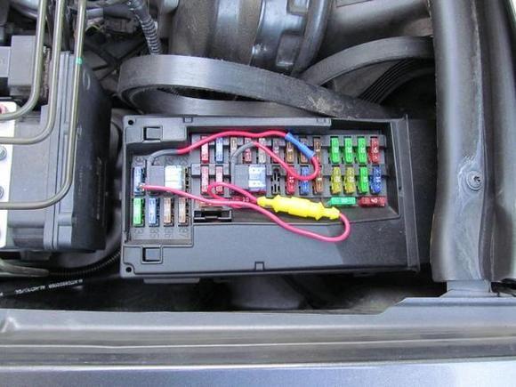

The radio power leads are easier to get to (well, you still gotta run your wires to the back of the console).
There are many battery and ignition sources in the fuse box under the hood - I have stuff wired to battery as well as ignition:
