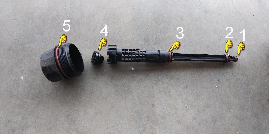

Originally Posted by Valk
Most including me have NEVER taken the stalk apart to replace O-Ring #4
Ditto that! That's why I always have 1 O-ring left over during an oil change.
