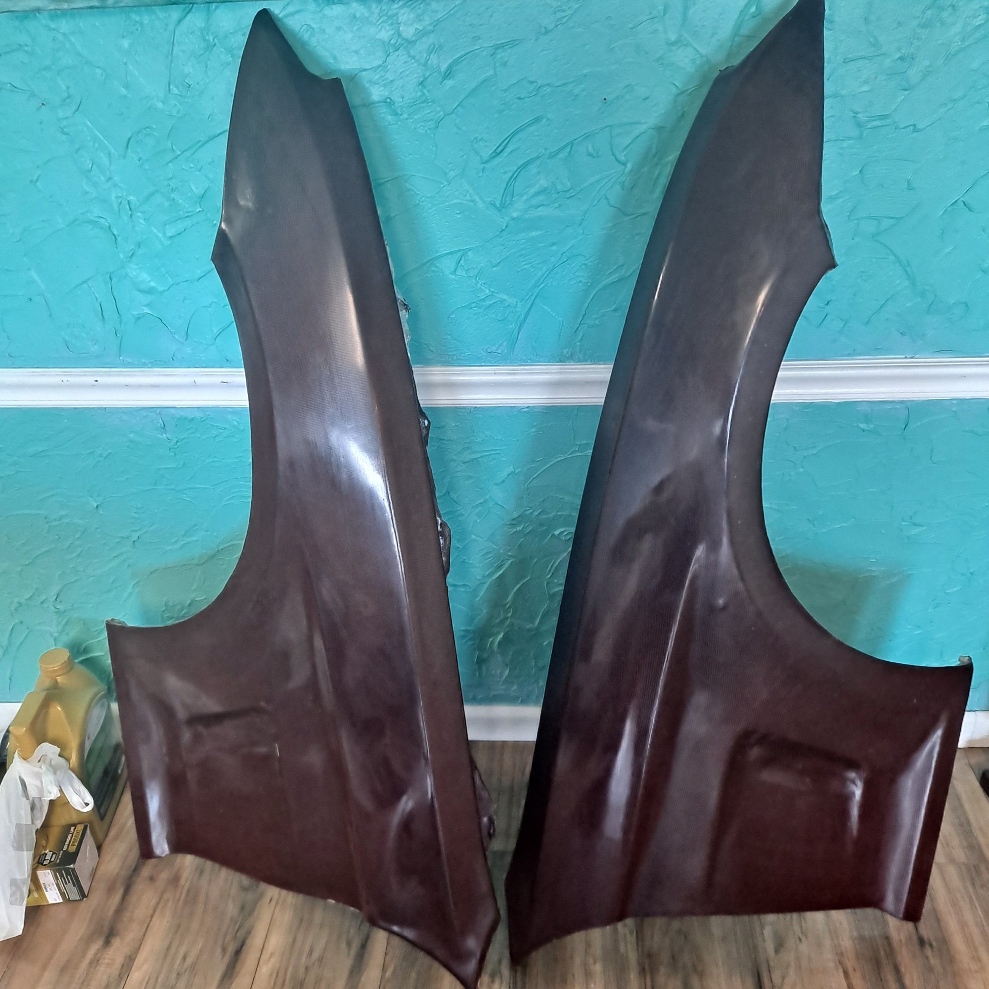

The fenders are done. The original 9.8lbs for one side to 2.4lbs in carbon kevlar red. It would be 14 lbs loss, but I removed the washer reservoir and components while the right fender was off. Lost another 2.5lbs ( empty). I'm putting the race stickers back on. I need them to hide some imperfections on the fenders.
Sanding
Fresh resin picture
Final resin coat
Buffed with Turtle Wax rubbing compound

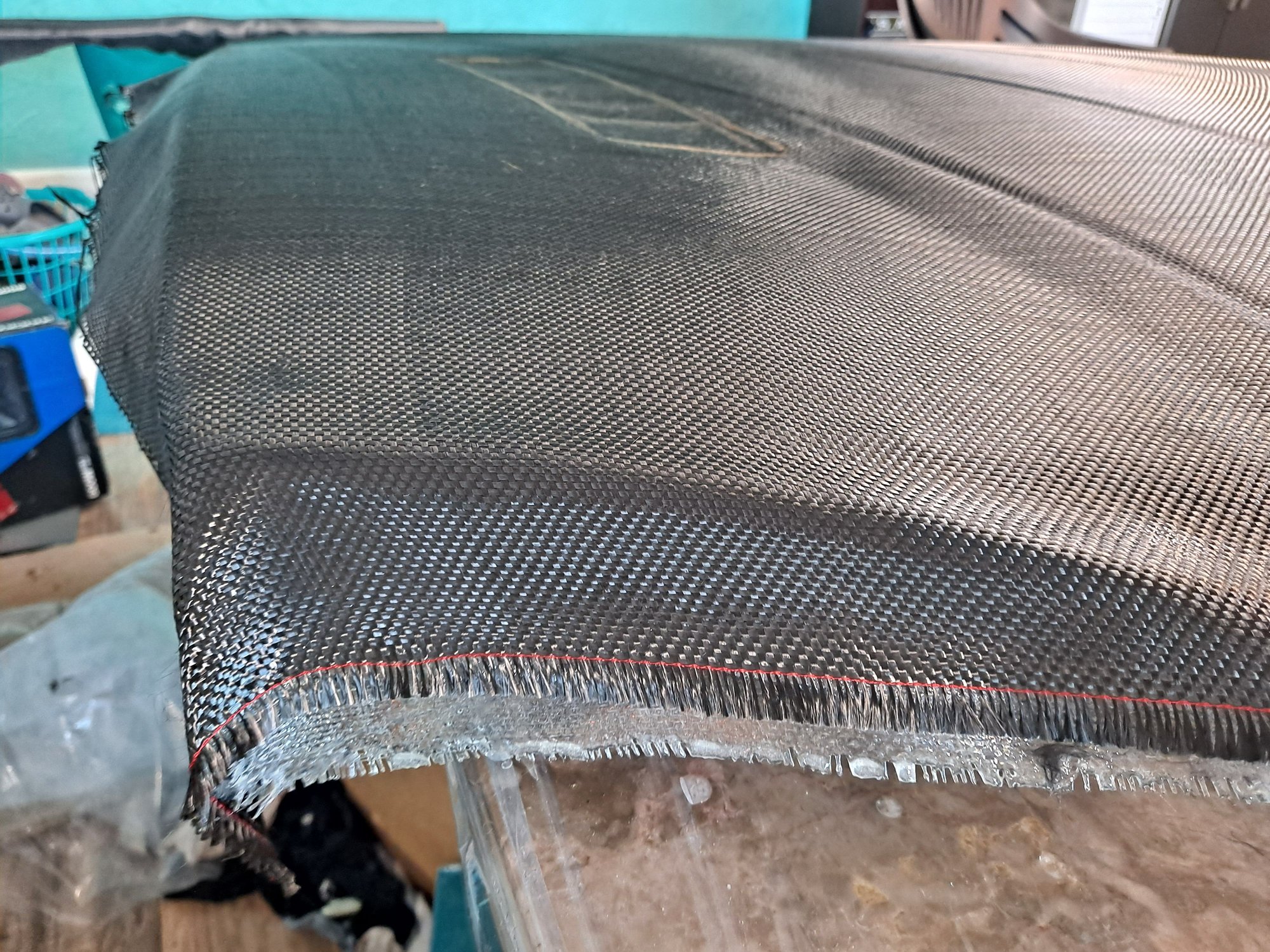

I'm getting better at this. I was able to sand this hood entirely by machine without burning through. The OEM hood is 50.5lbs. This hood was 8lbs before fiberglass framing, hardware, vents and heatshield. Once it drys I will weigh it again.
Needs vents, wet sanding and clear. Not sure if I'm transferring the stock chrysler wing here of sanding this one into shape.
