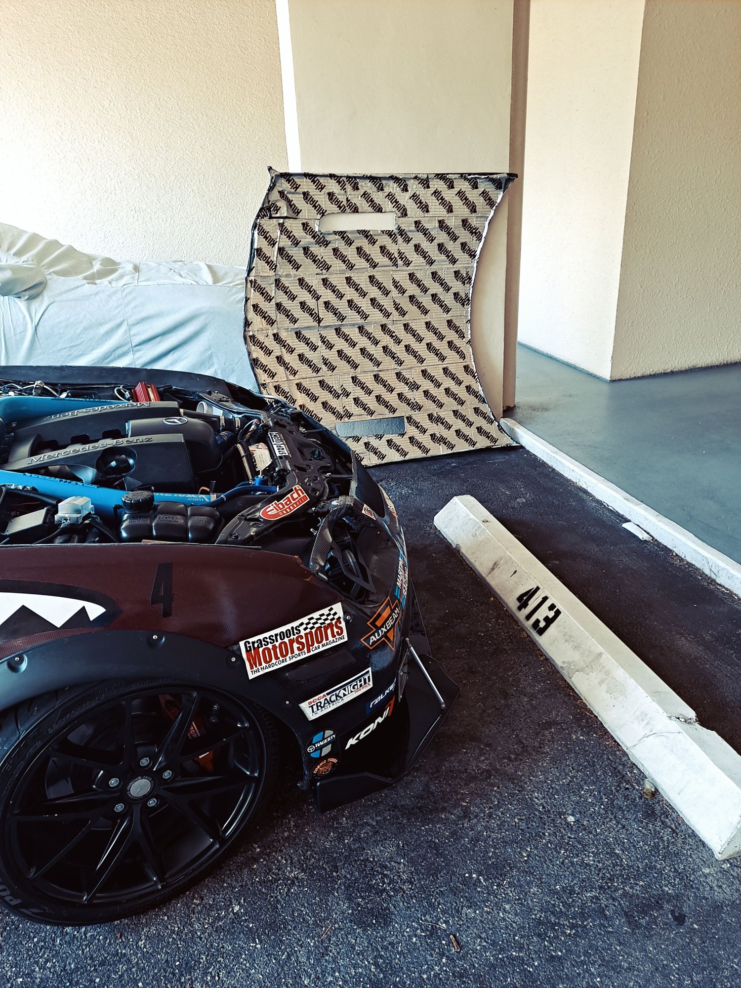

Why heat shield the hood? Won't it keep more heat in than out. The cooler the engine bay the better, or will the carbon fiber without the installation act as a heat sink and maintain too much heat? On the original fitment there is a seal that runs from side to side across the back of the engine bay. I wonder if the removal of that rubber seal would help move air out of the engine bay and thus help with a cooler engine compartment. The lower edge of the windshield is generally a low pressure area.

I have two weeks to finish this and a door than it's autocross time. I'm depending on weight loss and a couple of new nitrous controllers to make up .900 sec on a 55 sec lap.
Heat shield 6 pounds
Heat shield self-stick
I F2j5⁵
I tried that a few years back, didn't seem to effect engine / IAT temps, but it worked real well to put oil mist on the windshield

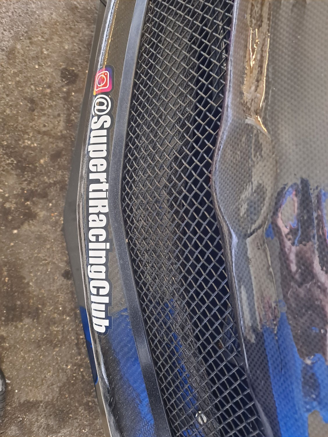

I took that rubber piece out. Yes on the new hood air flows out from there In fact I had to fasten the hood with 10 different spots. It wants to fly off because the headlights are open to get more air in. But it's summer the cars seats waiting in line at the hot track. Feels like 103f.
