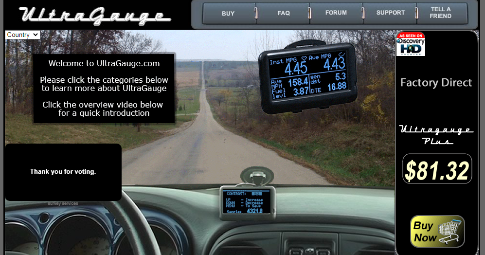

Old Sep 14, 2021 | 08:51 AM
Default Re: cooling the motor by removing the pan under
Originally Posted by phil alvirez
could you tell the temps on your xf? and how that shows on the gauge? thanks
I can see the actual temp ( F or C ) on my Ultragauge
