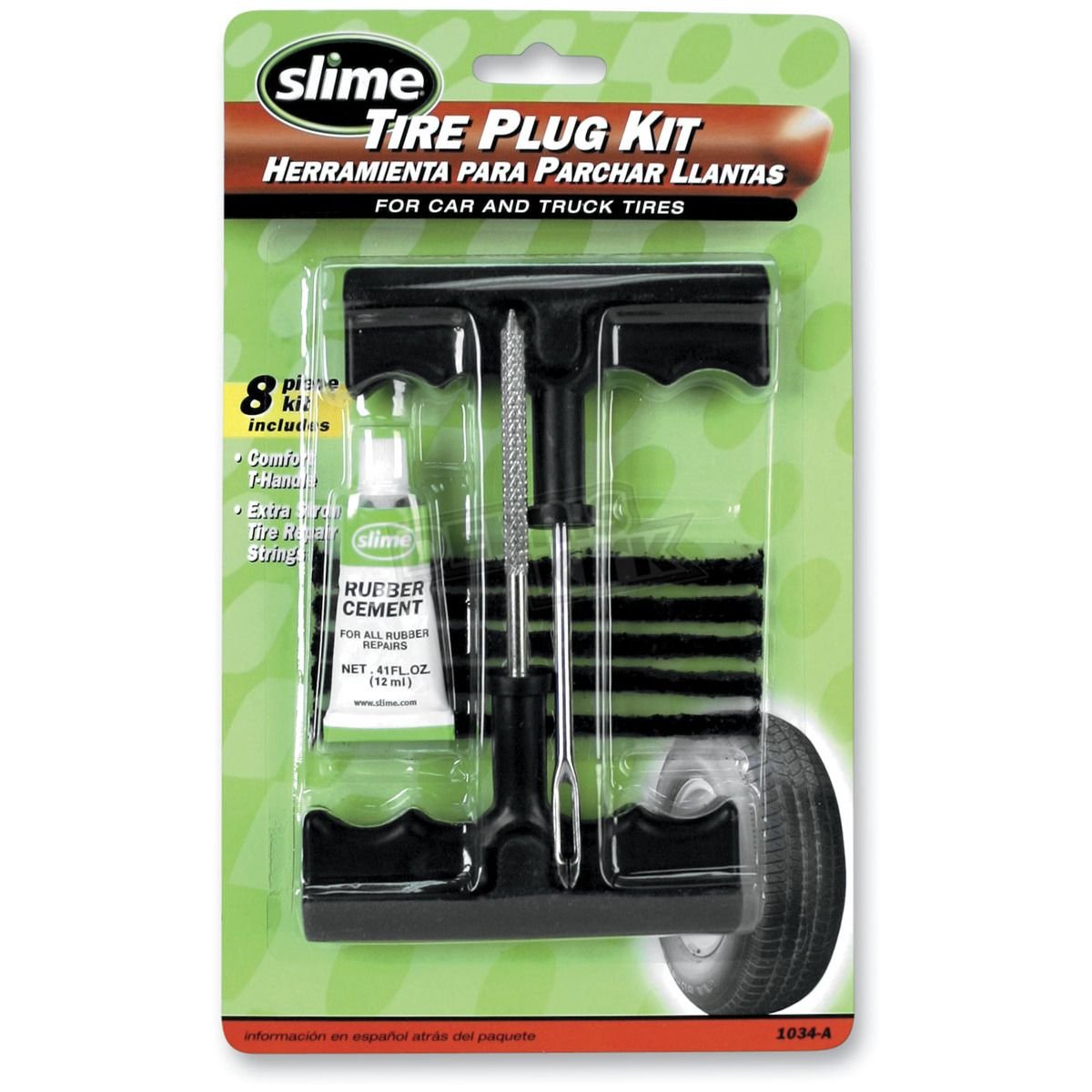

Same way I do on my bike. Used this kit twice in thirteen years and over 100,000 miles of Roadster ownership.
That's a very good kit but you have to check it from to time, the rubber cement hardens or starts to leak. Either buy a new kit or more rubber cement.
I usually just buy a new kit each year as my season begins
