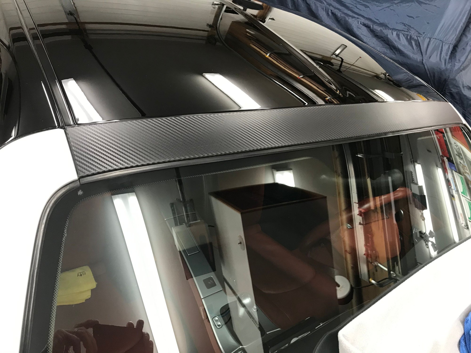

FWIW- I wrapped my windshield surround a couple of years ago without removing the trim pieces. It had a couple of rock chips on the top piece and I didn't particularly like the silver color against he black paint of the car. If you wrap it yourself you might find it easier to leave the surround in place.

I went with VViViD XPO Black Carbon Fiber with "Air Release Technology" vinyl wrap. Watched a bunch of videos on YouTube and then did some practice pieces. A heat gun helps and some sharp cutting tools.
Really nice work! I would have never imagined doing this!

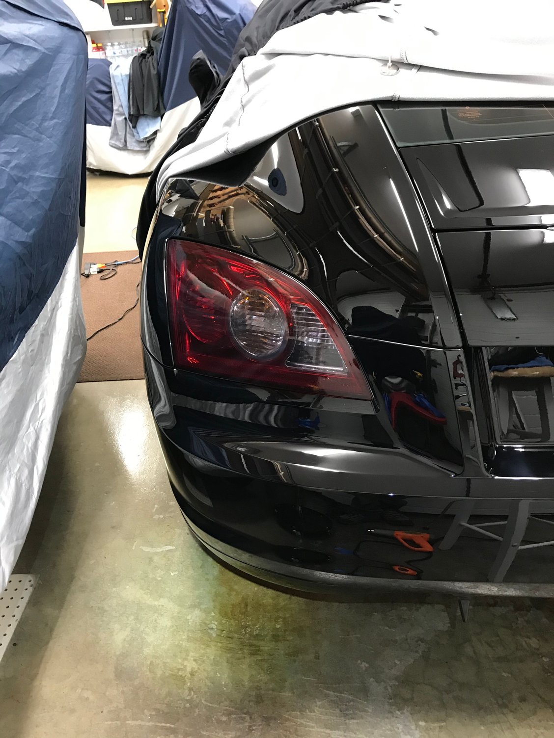

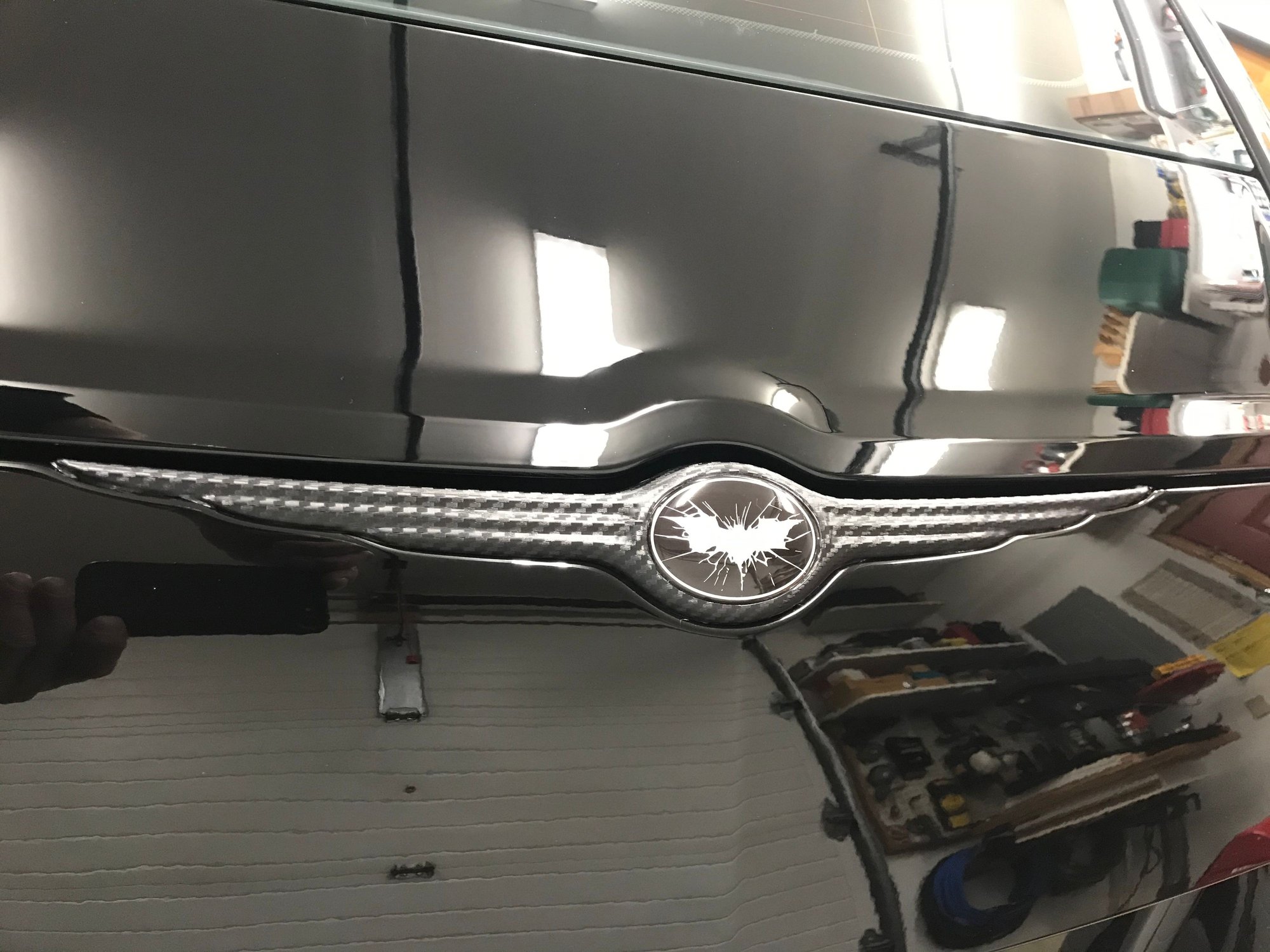

Thanks. There's a guy on YouTube "CK Wraps" that does some incredible work. Most everything is available through Amazon. I played around with tinting the tail lights and rear badge.

Thanks. There's a guy on YouTube "CK Wraps" that does some incredible work. Most everything is available through Amazon. I played around with tinting the rear badge.
Wonder if this product would work on the 'plain jane' badge on the Crossfire Airbox?

I don't think it would work as well as taping it off and using some spray paint made for plastics.
