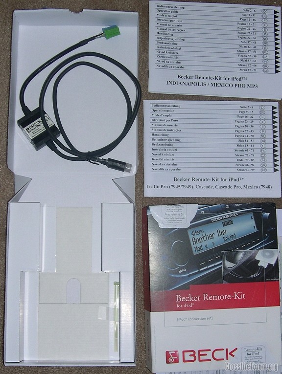

Okay, so I FINALLY got the Becker iPod cable adaptor for Becker stereo systems.
(Just under $140 US shipped from Europe).
It does NOT function with the Crossfire OEM Becker stereo with NAV.
The Becker 2660, 6 Disc, CD-Changer DOES function with the Crossfire OEM Becker Stereo with NAV.
(Changer is a reconditioned unit out of a Porsche, so I got it for under $300).
So, I had a cable that didn't work and a changer that did... what to do... what to do...
Well, I decided I wanted my iPod input more than the CD-Changer, so...
1. I separated the green and blue plugs from both the iPod Remote Kit cable and the CD-Changer cable. I kept the blue plug from the iPod Remote Kit and the green cable from the CD-Changer. I then assembled these two plugs as they just clip together.
2. I tapped the +12VDC power from the green CD-Changer cable jack into the iPod Remote Kit cable green jack to power the iPod Remote Kit cable. This allows the iPod to charge properly. I used a meter to verify polarity even though the CD-Changer cable was color coded properly (red for positive [+] and black for negative/ground [-]).
3. After hooking this combo cable into the OEM Stereo head unit, the CD-Changer came to life as always, except it had no audio.
4. I plugged in my iPod and the audio was piped in with the changer selected on the head unit.

The Becker 6-Disc CD-Changer (model number 2660) works perfectly by itself, no fuss, no muss. Just plug it in and it works. You don't even have to run additional power to it... it's in the cabling with it and is switched on through the stereo unit. I would check on e-Bay or with Becker North America for any more 2660s that are reconditioned (they come with a factory warranty after all).
