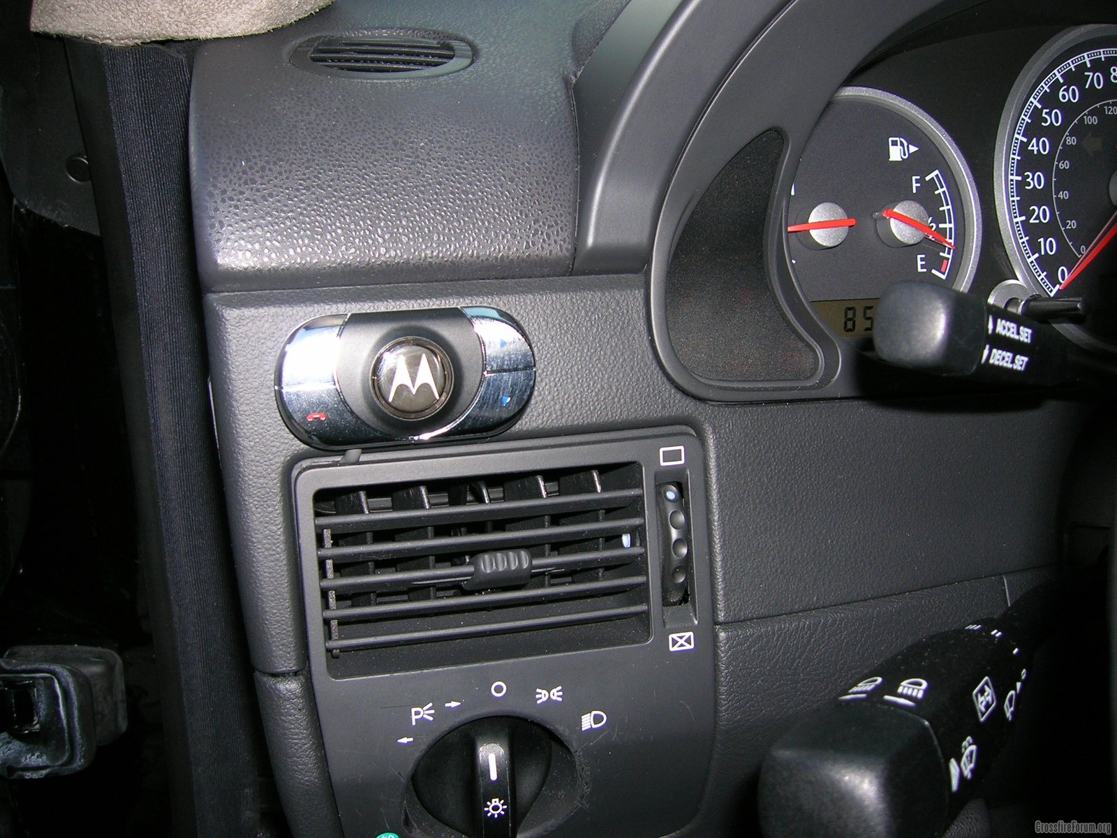

Here is a picture of the keypad installed...the rest is under the radio and dash so I don't have pictures of that...
Old May 28, 2007 | 11:28 PM
Default Re: * BlueTooth * ?-Help/ Advice needed
Thanks, this is the pic I wanted to see. I wanted to see what it looked like from the interior. I guess this will be my next mod after my seats.
