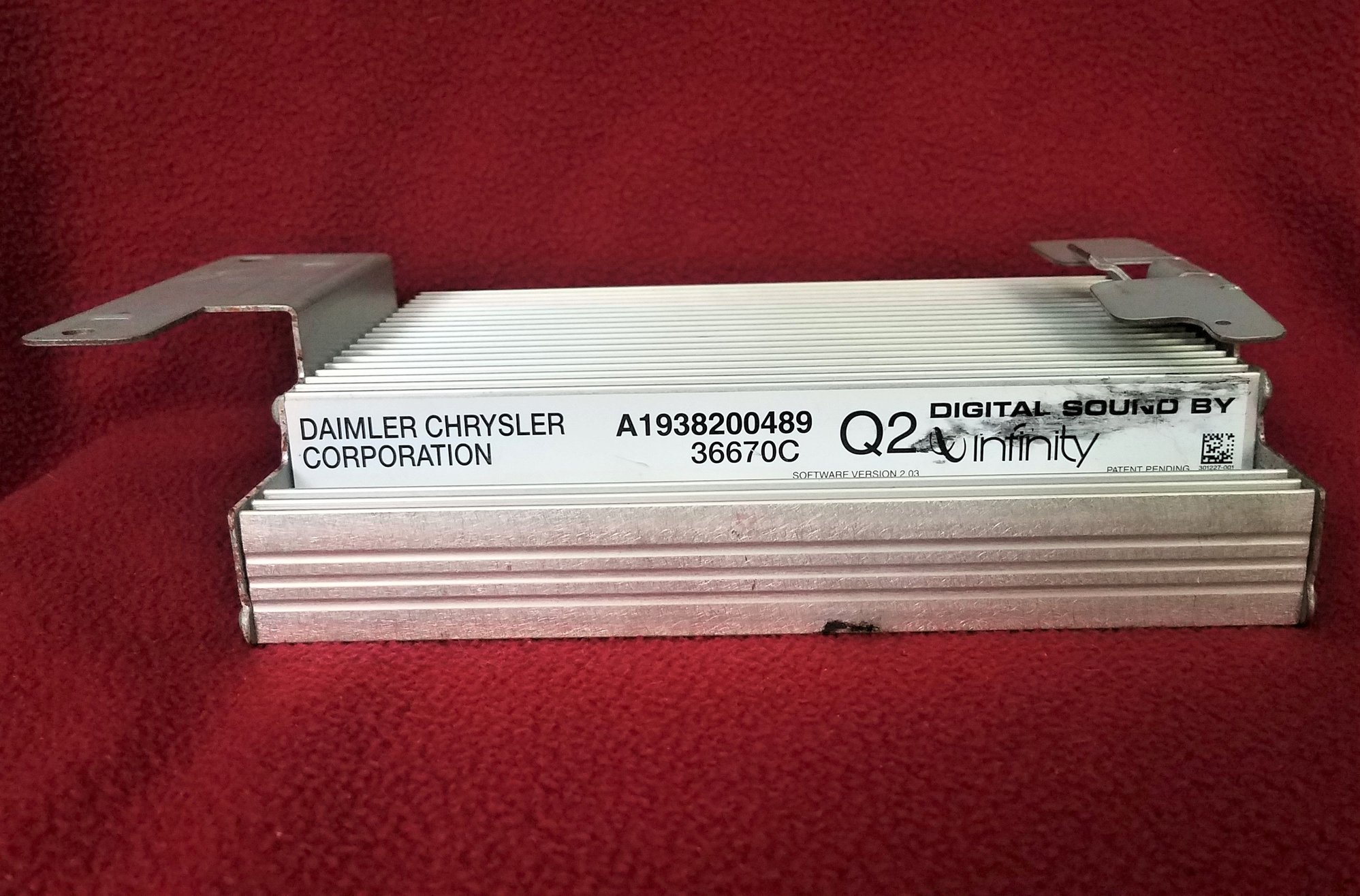

I went to a u-pull-it junkyard today and saw 3 of these in Jeep Grand Cherokees.
First one I saw, I grabbed, it was from a 1999 and then I found another in a 1999, then a 2002. I only took the one from the 2002, and a length of harness so I have spare plugs and wires to mess with.
The part numbers I saw were
On the 1999s, 56038407AD & 36670
On the 2002 56038407AF & 36670C
If someone else has a need for one of these, I could grab one if they are still there next time I go.

Well looks like I may be able to rain on everyone's parade. I Just tried the amp in my car, and no sound, and it is a different size. It is noticeably longer. I will check it out more later today/tomorrow, and take comparison pictures.
The shape is similar, but swapped end for end, and the brackets are different. The connectors are the same and plug right in. I got 2 of these, so if I happen to have a dead one, I will try both.
