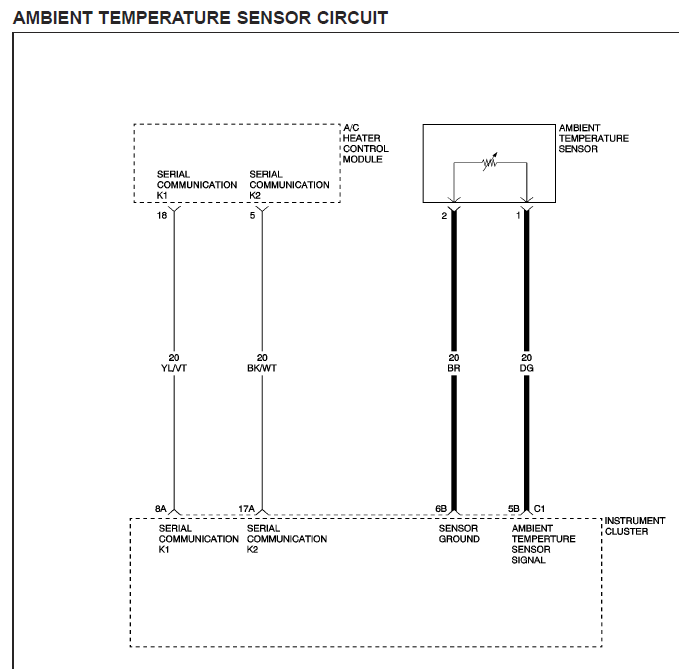

Thanks, but I can’t figure out how the wiring is routed from the sensor. Any figures/illustration would be welcome.
Old Jul 23, 2021 | 11:15 PM
Default Re: AC not working and outside temperature sensor acting up
As far as I know, there is no routing info in the service manuals, but here is the schematic :

George, Thank you for posting the wiring diagram! You make it seem so easy; yet I must take pictures, send emails to myself and save that to a file then finally download.
