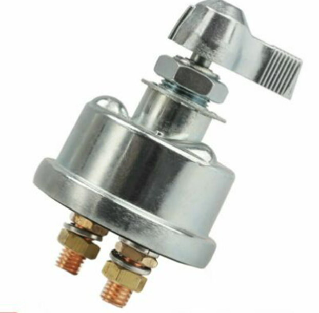

Suggestion: For those owners who do not drive their xfires very often or are experiencing unknown issues causing battery drain I recommend installing a HD SPST in series with the battery ground cable shut off switch. See example.
Good advice, If you install one like advised @ Heavy Duty (HD), make sure it'll handle the starting current for the time it takes for the car to start. Also, when you turn that switch back on give it a few seconds to stabilize the car's electronics. You have to install this on the NEG cable before any other wires (accessories you added) attached to the NEG at the battery, or a back-feed may hurt any equipment you installed (and if it is 'always-on' or internally completing a circuit), it will back-feed and draining the battery regardless, and maybe burn up something electrical in the car. Reason installed on the NEG side, you want to isolate the negative of the car, the alarm is designed to sense a tampering (removal/isolation) of the positive as an attempt of intrusion/theft, alarm will sound if alarm is working. Good luck!

Agreed Graphite Ghost. I believe I said connect in series with the battery ground cable which is negative. I am not familiar with the 3.2L starter motor power consumption specs. The switch shown can handle 20amps continuous and 125-amp spikes (1.5 KW).
