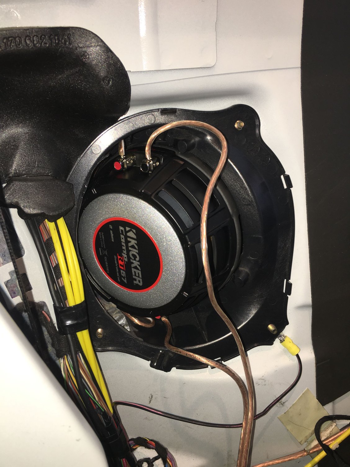

kicker has both subs and an amp that will work.
power for the subs (6-3/4” max size) comes from the amp

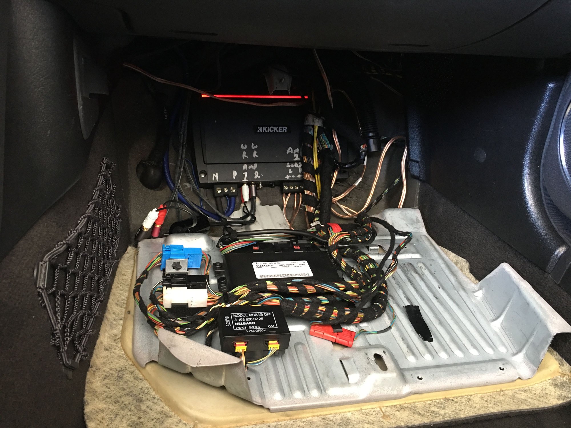

Mine came with a JL 4x100 amp... and stock subs... ordered a replacment pair... will see if they fit without modding the holders.

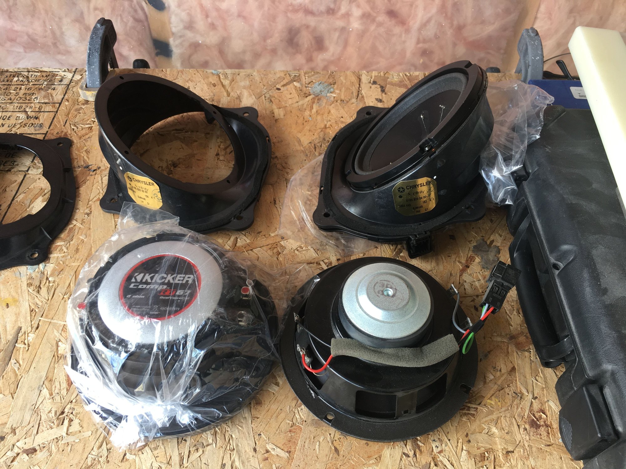

Originally Posted by nemiro
@UrbanE do you have a part number for those Kicker subs?
I sure do, they are also listed on the back of subs in the image shown in previous thread.
Kicker
43CWRT672 (Discontinued)
I believe the part number has been changed to 48CWRT672Comp RT 6.75" 2 Ohm Subwoofer | KICKER®
I did a quick search and they appear to be the same dimensions but I would encourage you to dig into it before ordering. I would hate to guide you in the wrong direction.
(I have other images if required, just PM me)

noting that the oem subs needed new surrounds, I removed them... figured out that the oems were dual 2.25ohm coils...i decided to refoam them.... they are now powered by the JL amp that the original owner had installed... they sound pretty good...
