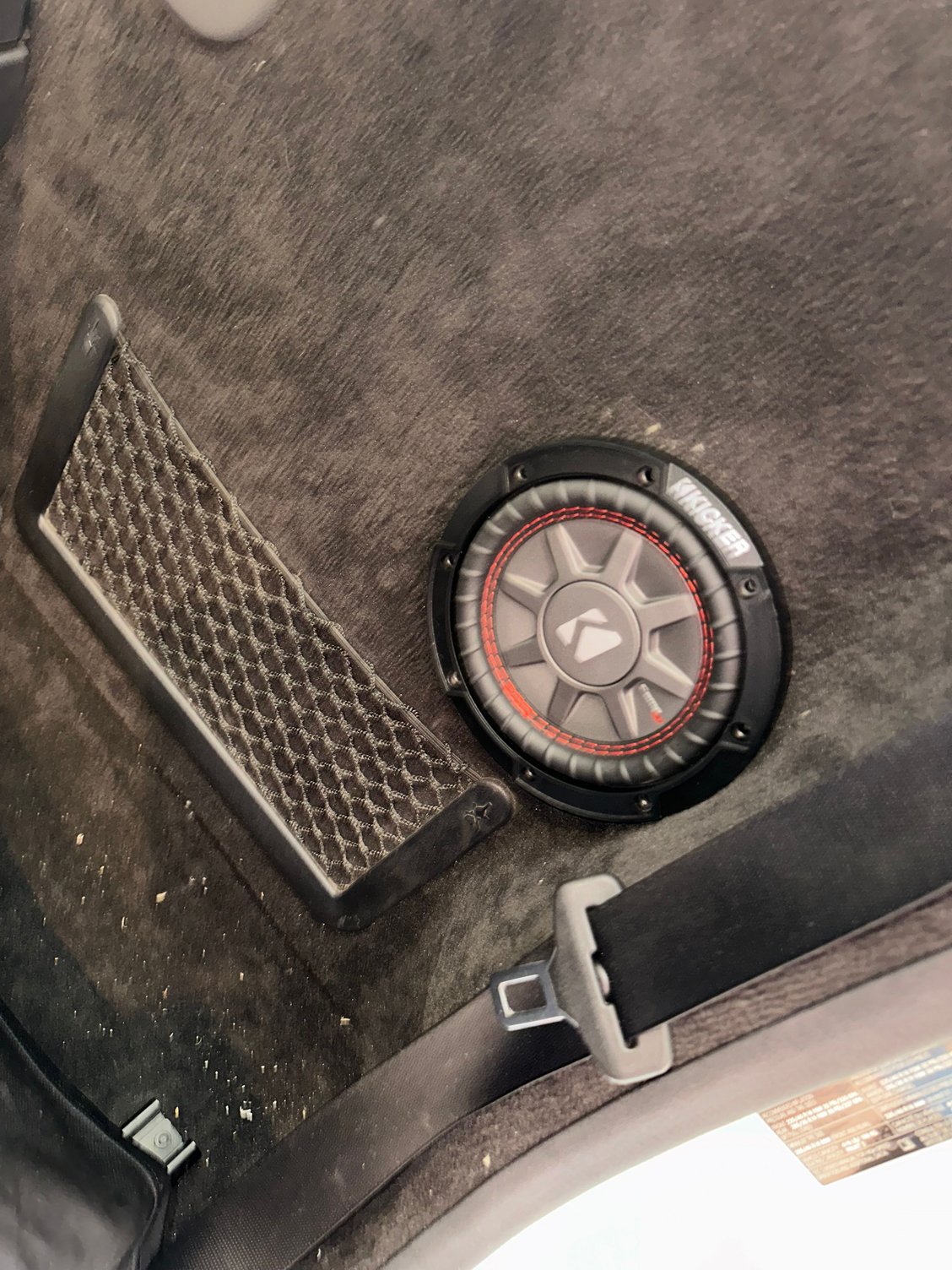

I did. I think they sound better.
I had to make custom mounting brackets.

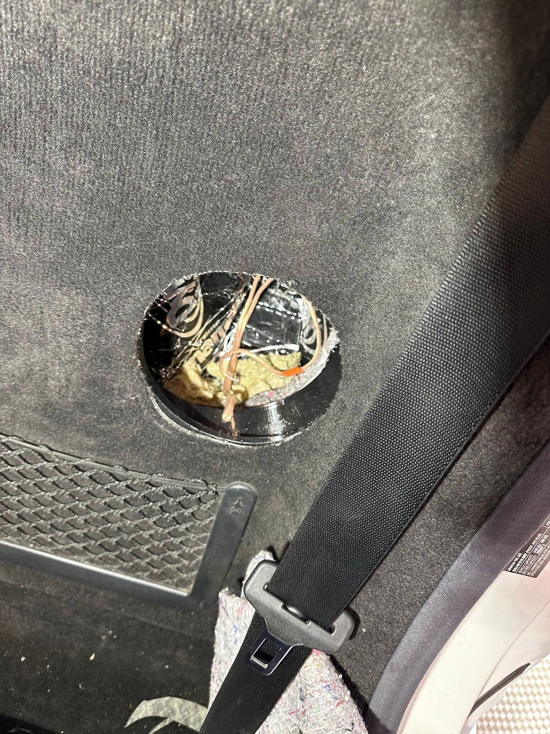

Yes, but I had to cut the holes in the carpet larger. Check out my pictures.

Finally got new 3d printed forward sub mounts installed. Installation went smooth. Sound as good as my originals. Willing to sell my old pair for $50.00 plus shipping. Would prefer to sell to a senior member (someone with credibility on this forum) to get their opinion. P.M. me if interested. May buy a 3d printer myself to lower price if I can get enough interest.

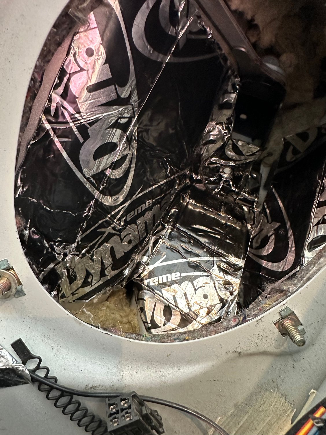

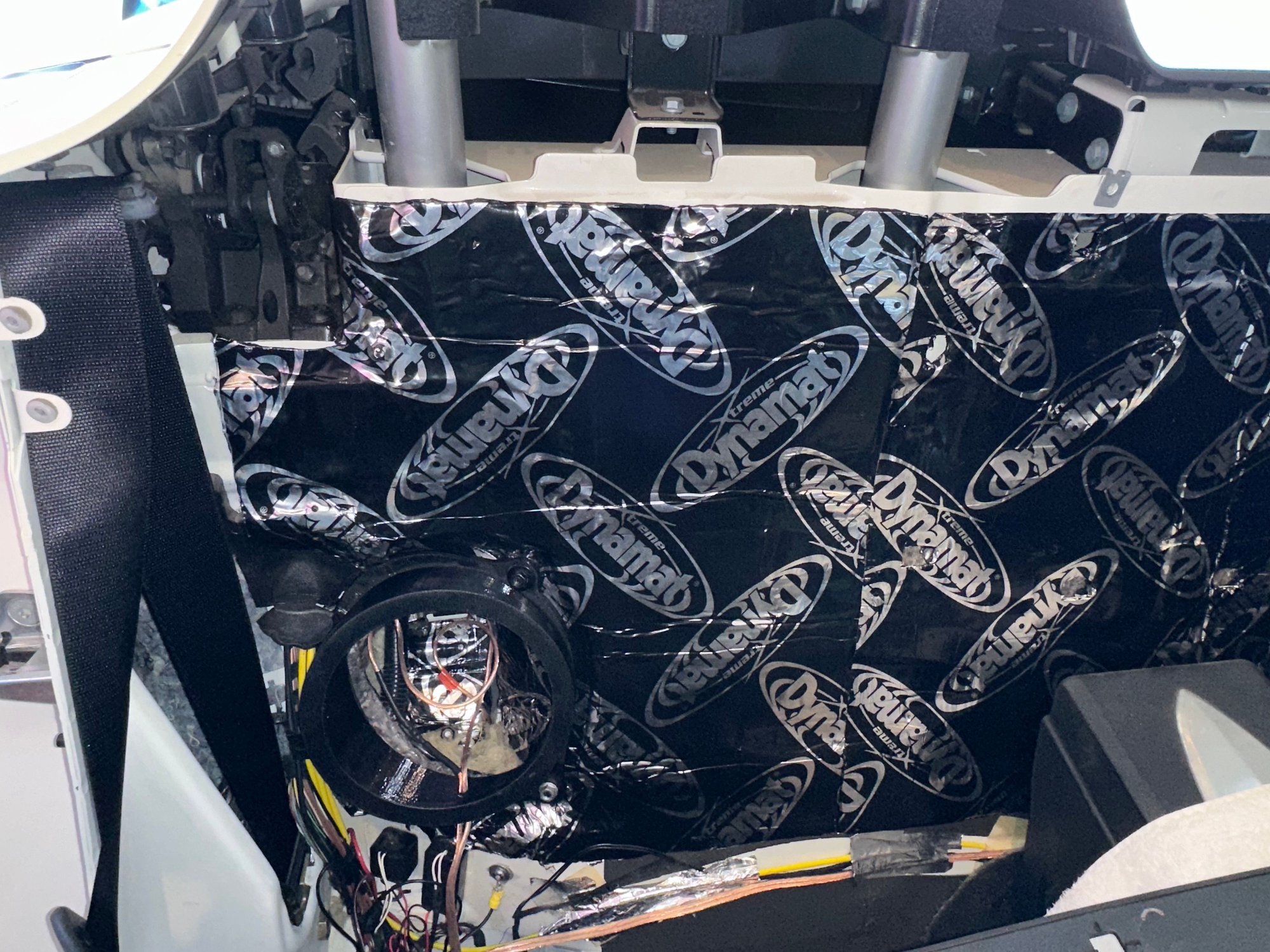

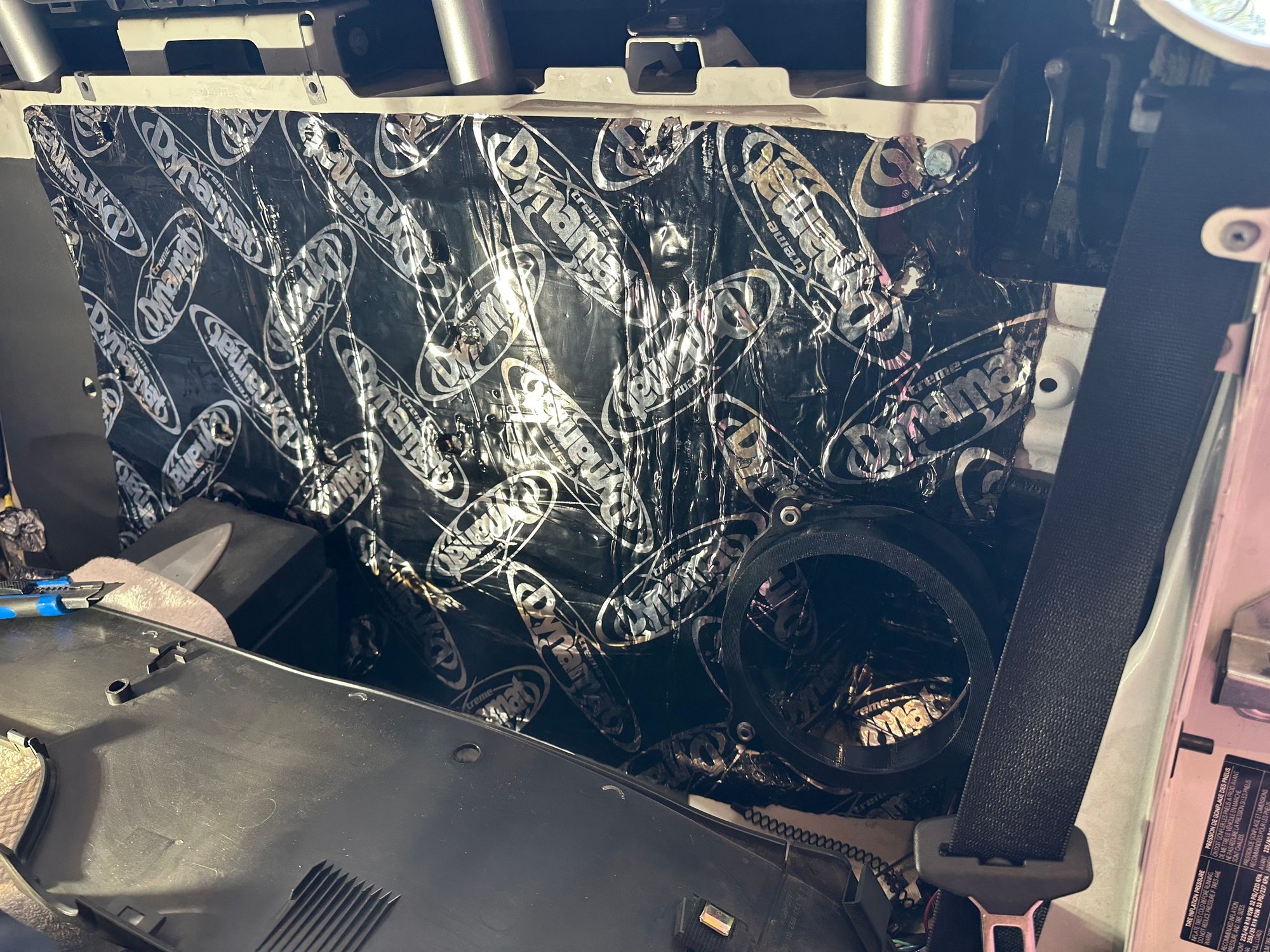

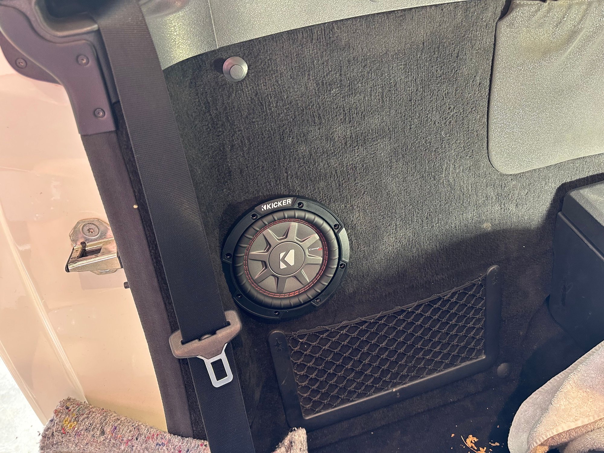

I finally got around to correctly installing my front facing subs.
I was fortunate enough to get a set of the 3D printed front facing sub mounts from Chynnalou.
I started by applying Dynamat to the bulkhead and the interior of the sub cavity.
Then I installed the new sub mounts.
I run the kicker subs as rear mid bass speakers (not plugged into sub jack) they are run as rear speakers.
What a crazy amazing difference. On the highway, roof down, windows down 100km/hr. The sound from side speakers and bass from the back was incredibly clear and loud.
Dynamat in doors too.
the dynamat really helps in the doors and the bulkhead.
Chynnalou the quality of your printed subs mounts is amazing. Everyone should get a pair.
