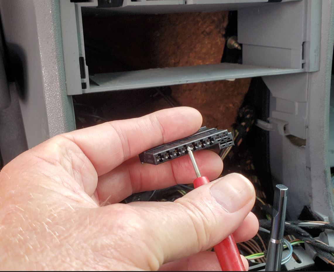

I have checked the ground as you said and got .75 Ohm..
Connector pin 8 to ground = 8.5 Volts, but at the BCM it measures 12 volts. This means different voltages at the two ends of the same wire.
Voltages at pin 78 are the 12 volts when opening and losing with the fob. But nothing happens when using the switch.
I am truly confused.
Thanks for the help.
Pin 78 Do you mean pin 8?
From what I am reading, you have 12 volts at the BCM pin 49 and 8.5 volts at the switch pin 8.
Do I have that right?
I'd bet if you press "UNLOCK" that the voltage at pin 8 will go to Zero like is should, and at pin 49 it won't drop, it will stay at 12.
This would indicate the wire itself is partly open, that is, resistive. This would lead me to question the crimp on the wire BCM pin 49 or the crimp on the wire at pin 8 of the switch.

I currently happen to have my console switch out. I measured the resistance of my switch between pins 4 and 8, and got 200 ohms and 0 ohms - same as your measurements. I measured the resistance from console switch group (csg) connector pin 4 to ground, and got less than 1 ohms. I measured the voltage between csg connector pin 8 to ground, and got 12.34V, no key in the ignition. I tried shorting the two pins together, but the door locks didn't close. I then put the connector back onto my csg switch, and everything worked as it is suppose to without the key in the ignition. I'm not sure why the jumpering didn't work, but maybe the BCM is looking for the hazard switch connection as well? An interesting aside is that I had the drivers side door open, and door lock button stayed opened during the test while all the other locks opened and closed (At this point I thought I had another problem..) Fortunately, when I closed the drivers door, both sides worked normally. Interesting feature.
-Jerry
Probing the console switch group connector, pin 4 should go to ground. Pin 8 should read 12V even without the key in the ignition.

Shorting them unlocks the doors. Applying 200 ohms between them locks the doors.
Do I have that right? ………(Yes)
I'd bet if you press "UNLOCK" that the voltage at pin 8 will go to Zero like is should, and at pin 49 it won't drop, it will stay at 12………… (correct. But it stays at 12 unlock or lock)
This would indicate the wire itself is partly open, that is, resistive. This would lead me to question the crimp on the wire BCM pin 49 or the crimp on the wire at pin 8 of the switch……….(I will check tomorrow)
-Jerry
Jerry at least we get similar figures, I think pizzaguy is on to something with the nad connections between the wire and the pins. I study that tomorrow. Thanks again .

I guess I missed this post. Yes, I agree with Pizzaguy, you likely have a problem with the wire feeding pin 8 - it should be at battery voltage. Also, 0.75 ohms seems high for ground, but that could be your meter. Have you connected your leads together to see what the resistance of just the leads are? If that's high then okay, but if thats low, like less than 0.1 ohms (hopefully, more like 0.01ohms). I don't know if you would feel comfortable doing this, but you can short pin 49 on the BCM to ground or wire your door switch directly to pin 49 (i.e., connect a wire from pin 49 to pin 8 of the door switch, and connect pin 4 of the door switch to ground. Now you have bypassed the wiring, and hopefully the door switch will work normally). If you connect pin 49 to ground, I would think you'll get my results, and confirm it's the wire between pin 49 and pin 8 that's your issue.
