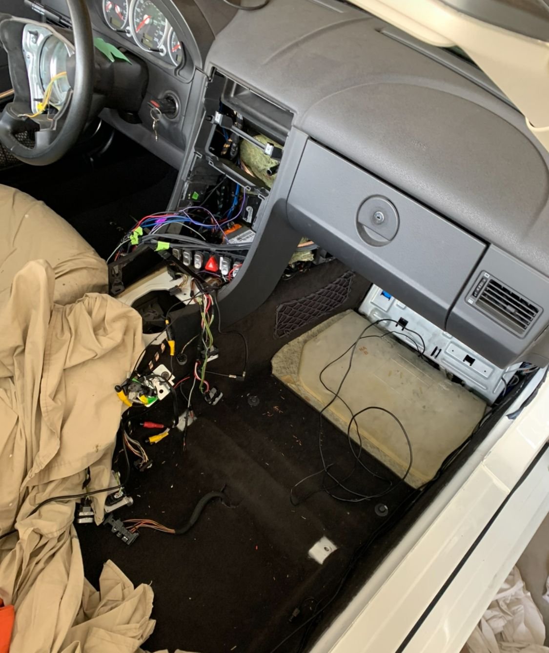

So i have posted some pictures that depict the relocated screw holes to allow the faceplate to be mounted lower on the fascia. (clear the buttons) These particular pictures are a metal case and faceplate from one of the "graveyard" chinese radios that I have.laying around.
The side view also depicts where I will paint the chrome paint on the edges of the faceplate, so it matches better with the present fascia.

I installed the Rockwood Fosgate speakers back where the woofers fit in a limited. I had to use the forward speaker mounting adaptor provided by a fellow forum poster. Since they were component speakers, I mounted the tweeter within the headrest plastic under the roll bars. Ran the wires down the passenger side as described in other posts. I ended up not installing the back speaker wire using pins on the factory harness and just wire it into the radio connection with disconnects.
I installed the GPS antenna under the dash on top of the metal brace, as described in the factory manual. I tested the signal, and it picks up the GPS satellites really well. Gets that GPS wiring out of the way.
I installed a backup camera with a bar frame on the bottom bolt holes of the back license. The wires from the camera are run behind the plate up to a break in the weather stripping in the trunk. From there it goes to the right backup light where it picks up power and a reverse signal. Found a gap and ran the wires to the radio utilizing the same route as the back speaker wires.
I took the screws out of the front face plate of the radio and shifted the screen slightly down (tab on the bottom faceplate is now below the case. Turns out there are no wires or components where the new holes are drilled, and the faceplate has the optimal placement between the upper and low console controls.
I mounted the two external USB cords in the back side of the inside of the glovebox, so it will close without any issues.
I did some testing with the radio sitting on the console. Android auto works very good wirelessly(don't have carplay). Reverse camera works and I got the suite of google android apps. While Google maps works, unless I use my phone as a hot spot, it won't update the traffic. I use Android Auto for the maps any way (dual screen). Amazon music and sirius XM (Internet) work as designed within Android Auto.
I used the phone (internal app and Android Auto) and it seems to work as intended with the microphone within the radio. I have not tested the microphone at speed with the top down.
I speakers sound very good with great separation. With the surround controls and equalization, there is a lot of customization. Is it 10" powered subwoofer base, no but it does pretty good for the 4-6.75" speakers. Still need to fine tune the tweeter levels once I get it permanently installed.

Since the Crossfire is built so good, the slot for the radio is part of the console frame and it extends quite deep back on the radio. Other manufacturers have radio support in front and support in back but rely on the on the provided slide in case to hold the radios steady. Also, the sealed-up console design of the Crossfire such that you don't have access to the connections on the back of the radio (after it is installed).
Mix this with the particular design of the back panel on the radio which has connectors facing up. This is great if the in-place connectors are not higher than the top of the case that fits into the Crossfire slot. The design defect is the Motorola Antenna connector, which is too high, whether you use straight connectors, right angle connectors, or the adaptor to match the stock Euro connector. This design defect prevents me from sliding the radio into the Crossfire radio slot with the radio antenna hooked up. There is room to lower the standoffs on the main circuit board to lower the overall height of the antenna connector (Design fix).
Obviously, the Germans have made it hard to access the back of the radio after it is installed to connect the AM/FM antenna.
So, my big question to the experienced folks on the Crossfire Forum.
If I remove the glovebox assembly (and I have a small hand), can is reach in and attach the AM/FM antenna connection after the radio is installed?
If so, there will be an added benefit of shifting the added wiring on the back of the radio for more clearance.
Thanks in advance for the insight!!!!

So I keep finding hills to climb. I can just get a little access to the back left top of the radio when it is installed, through the bottom kick panel on the driver's side (thanks to sticky key posts). But the crossfire radio housing that the radio slides into is too long for the vertical antenna nub. I have not quite notched it out enough to grant access to the antenna nub (which sits vertically).
I can fix that, but the next problem is the climate control assembly sitting above the radio. It goes quite deep back on the left side just above the antenna connection. So tomorrow, I notch the crossfire radio housing a little more and maybe there is enough clearance to slide the motorola connection in from the top if the climate control assembly cooperates. It would be easy if the climate control assembly went in after the front console. Unfortunately, the radio faceplate is on top of the front console.
The lesson is to get a radio with the AM/FM antenna connections facing out the back of the radio.
