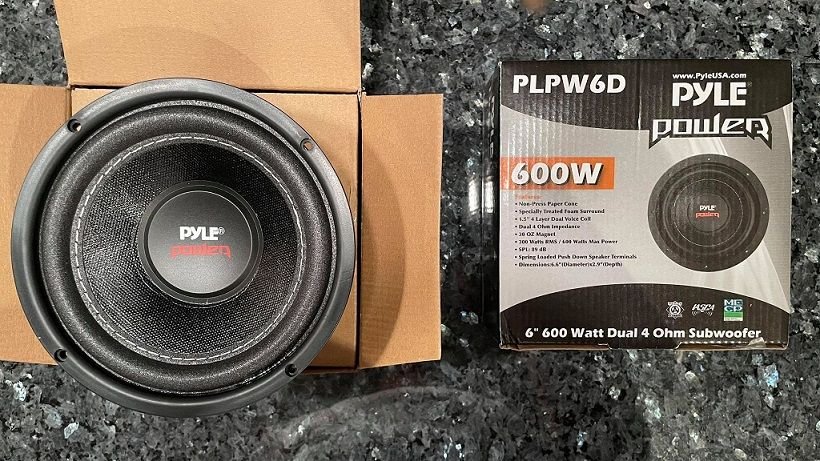

I bought these on Amazon in 2021 although they didn't fit without modifying the baskets they sit in
I don't know of any sub that fits without modification and that's why it is recommended to repair your with the new foam
PYLE PLPW6D 6" 1200W Dual Voice Coil 4-Ohm Subwoofer
