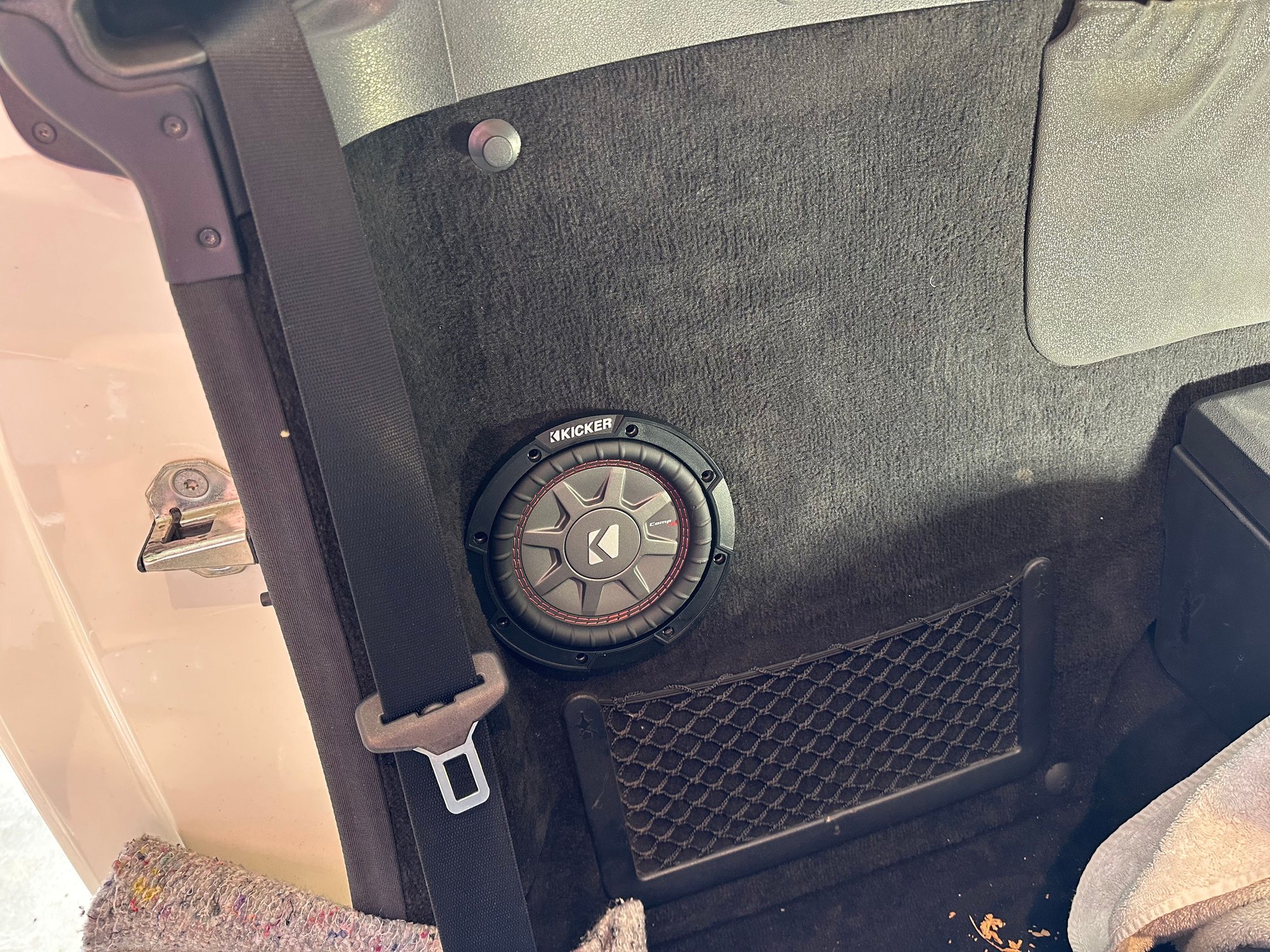

Had a lot of family over the holiday, so I got sidetracked. Got the front facing woofers installed. I placed some sound absorber mat inside the body cavities. I chose to use the factory wiring harness to the woofers. I added an extension to the four wires per woofer and drilled a hole in the side of the 3D printed woofer adaptor. I slid the extended wiring through the hole (outside to inside) so I would have enough wire to install the speaker after the carpet was put back. Tested the new woofers with the old head unit and wiring. Seems good, although I will be putting bass blockers on the door speakers. I still have some booming from the doors and I will be putting some sound dampener in the doors. Hopefully, the stock speakers are in better shape than the woofers (different surround material?). Will get some pictures of the exciters mounted on the back panel.
Getting ready to dive in on modifying the stock amp wiring.

I replaced the subwoofers in back with forward facing Kicker 2 ohm dual voice coil units. The are connected with the stock wiring back to the original Infinity amp that has been modified to be a four channel amp. The inputs to the stock amp are some RCA cables plugged into the left and right subwoofer outputs of this head unit. This head unit has separate subwoofer controls for frequency and loudness adjustment. The sound output from the 5 volt RCA cable setup combined with the modifed original amp and forward facing woofers. should be pretty good.
I should be able to retain the speed sensitive volume levels with this setup
So I just have to finish the wiring and test connect it before buttoning everything down.....
