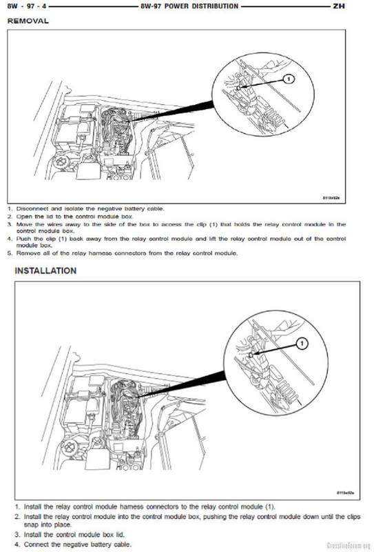

I called my service dept and asked them to see if it wasn't a relay control module and they were like "what kind of relay control module are you talking about??" So I gave them the part number and they said it doesn't really give them what kind of relay control module....
Print this out. Lift your hood and show them where it's at.
RCM
