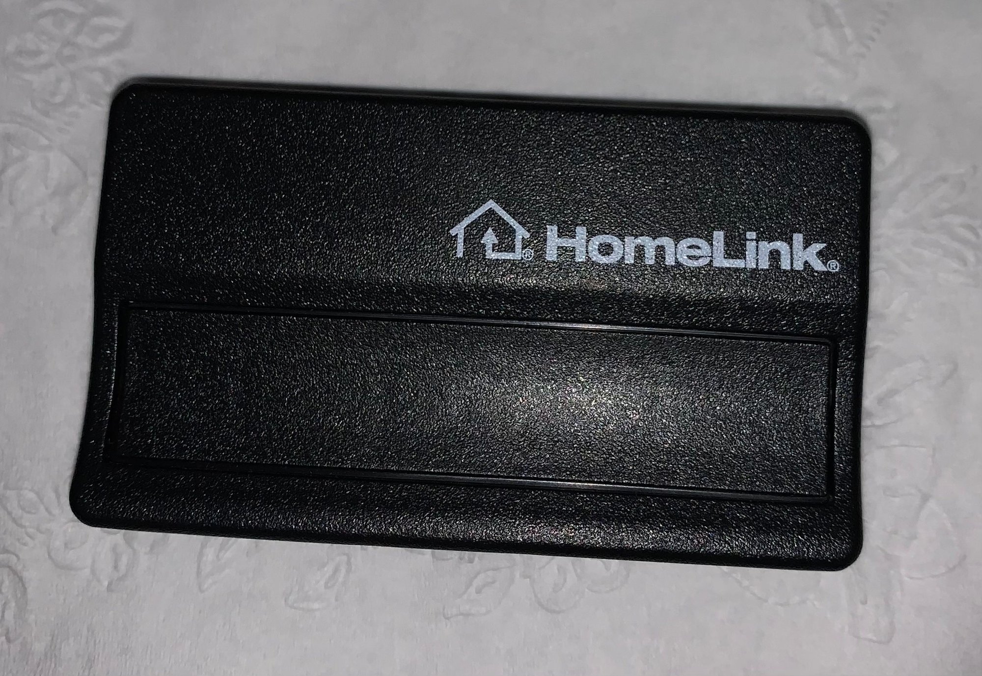

Default Re: programming garage door opener ???
Homelink repeater images
-Remote
-repeater
-instructions
The brand of garage door opener is Chamberlain
Please let us know if it works for you
