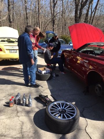

We did mine at a Tech day in North GA. I worked on sticky keys and sound systems while Zach and Nick did my fluids.
I can't tell you what they used, it's been four years already.
Shown is Nick putting my HAWK HPS brake pads on the front, while others watch and offer beer.
I was working on a sticky key at the time....
From your picture is has to be this:
https://www.mobil.com/en/lubricants/...ube-ls-75w-90/
Simple as that.
