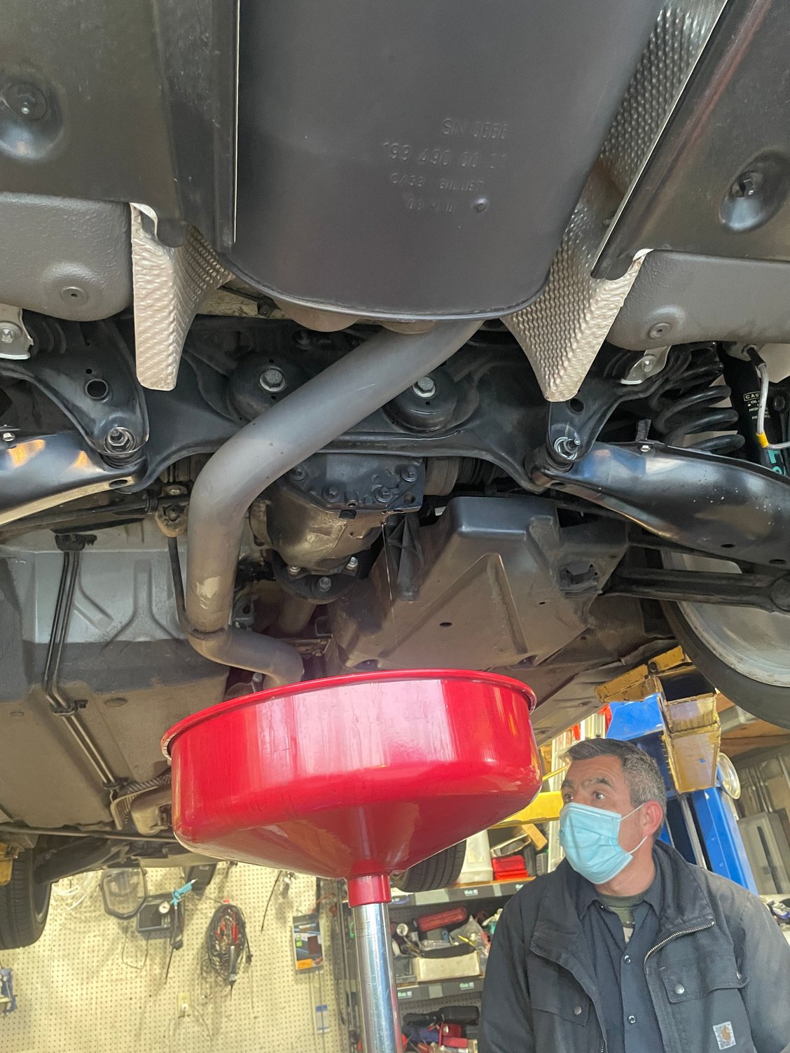

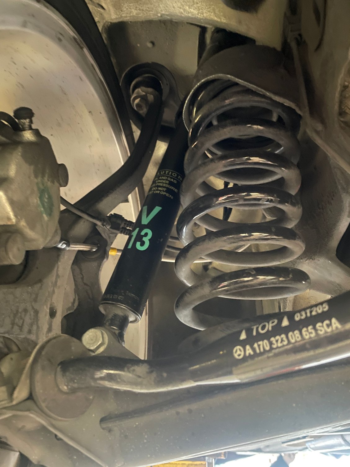

Good day UK & USA Crossfire enthusiasts!
Already noted, as there seems to be a dire fence in differential oil viscosity based on your car’s year. Per the manual, my ‘04 calls for 75w-140 synthetic oil, all others like 75w-90… But here’s my thought: oil viscosity is like a rubber band: low range numbers don’t have the same flexibility/range as a higher viscosity rating, so I would suggest going with a good quality Synthetic gear oil (members recommended numerous brands, all great quality), and pick the higher viscosity range, I think it provides as good, or slightly better in temperature ranges (dessert, to ocean). As I tour with my XF all over the place, best having the extra viscosity protection across a broader range of driving conditions. I just had my done - car has 15k original miles, some under carriage shots as wee. Cheers! AB

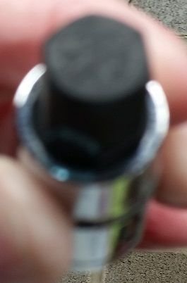

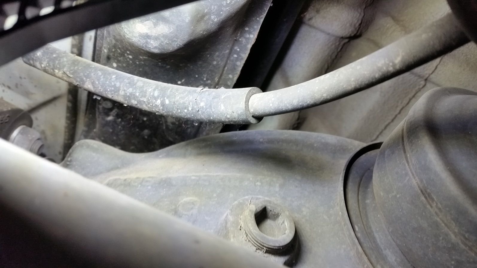

So here's the fill plug. I have the socket needed. Both the fill plug and the drain plug are 14mm Hex. Simple enough. I took super-blurry pictures so there can be no doubt! 🙄🤔 The fill-point is sorta blocked by the exhaust-pipe below & the emergency-brake-cable above, but you can get a "streamlined" liter gear-oil bottle (you know the shape, NOT like a bottle of engine-oil) on its side level with the hole. I'd definitely use either a pump or a 'squeeze pouch' to make the job easier.
