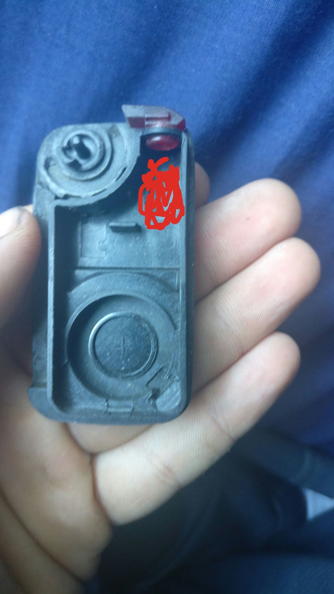

Old Aug 9, 2017 | 06:53 AM
Steve Jr's Avatar
Joined: Sep 2015
Posts: 1,465
From: Knoxville
Default Re: Key fob AND alarm not working
If you don't get the chip back in correctly, its not going to start. The black ring around the key assembly(hallo) and the chip in the fob work together to tell the system it is OK to start the engine. It HAS TO BE THAT CLOSE. Its not like some of the newer cars, where's its OK in your pocket. New key?? Call Rob @Needswings.com.

Old Aug 9, 2017 | 07:21 AM
Likes: 648
Originally Posted by dylan07
Well, I purchased it from a coworker's son about 2 or 3 weeks ago. He says he never had any issues with starting the car. I asked him before buying the car, because I noticed it was a common problem.
Right away I took the key fob completely apart, trying to replace the batteries in it. Later I found out there is an access door on the back so you didn't have to take it all the way apart. When I took it apart, I pulled the pieces apart suddenly and pieces flew across the room. The chip dropped on the floor, I picked it up not sure what it was. and gathered the rest of the pieces.
At the time, I didn't know it was a chip, it looked like a piece of plastic. I called the guy asking if the batteries had to be in the remote to start the car, and explained what happened. He said that it is chipped, and told me to place the chip or hold the chip near the ignition while trying to start the car, that worked. took the chip away, tried again, no go. Confirmed it was a chip. Also looking under a magnifying glass I could see part number, and other numbers that would correspond to security chip information.
I assumed I never put the chip in the remote in the correct place... But, now my issue is getting worse. At first it would only die once, and start right up the second time. But now... it's being very problematic. According to the previous owner, he never had issues with it starting.
He seemed honest, he told me every little thing wrong with the car, even minor things. I could give you a list of everything he told me and you would agree he seemed to be completely honest.
Is there anything else you have not told us?
The chip is glued or held right up close to the red window, you can probably see where it came from.
Old Aug 9, 2017 | 11:36 AM
dylan07's Avatar
Joined: Jul 2017
Posts: 58
From: sacramento, CA
I sense some attitude with that question, perhaps it was not intended. However, the chip was not glued because the previous owner replaced just the shell of the remote because the rubber buttons were cracking. He purchased a shell off Amazon or eBay and transferred the guts into the new casing.
Here are pics of how I put the chip in the case. The red ink is how I was putting it in at first. But the chip kept coming loose and was rattling in the remote and I would have to shake the remote to get the chip to the front of the case to start the car.
The yellow ink is where I have the chip now and it fit snug in that spot. It worked, so I thought the snug fit and it working meant that's where it was supposed to go.
