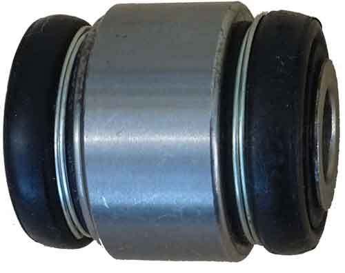

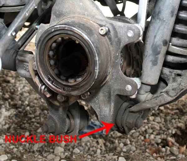

I had the same problem. My mechanic is a Merc specialist and it is a common problem caused by the rear lower Knuckle bush (or also called the Rose Joint in the UK). Replaced both at only about £10 each (about $12) -problem sorted.

awesome, thank you val. Do you by any chance know how to replace them?
