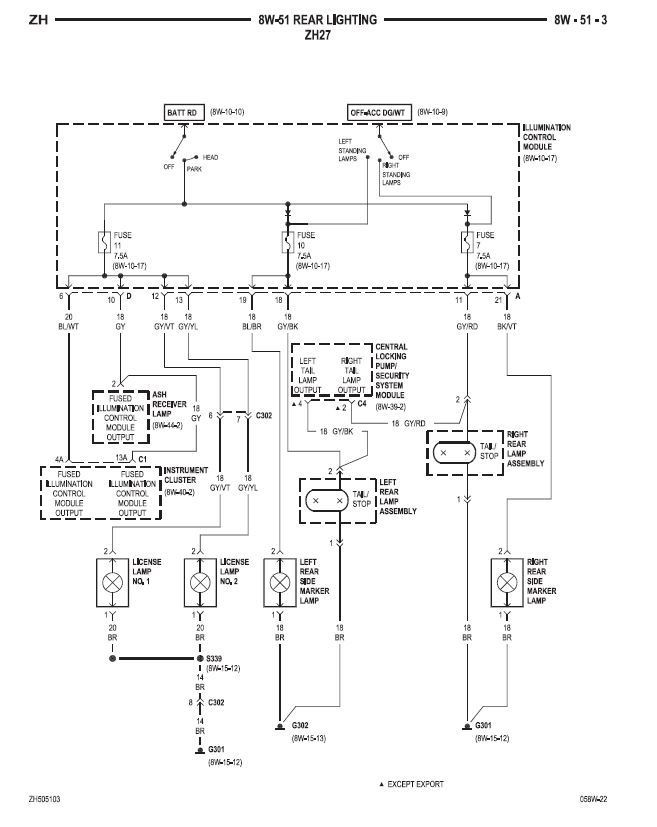

05 crossfire. System is charging and battery is good. However, rear left taillight stays on constantly when car is off (turns off once cranked up) and the battery drains within an hour or 2 and has to be jumped everytime i drive. I removed fuse 9 when this started before i realized light was staying on. It stays on whether i lock the doors or not. When i turn lights on both taillights work, but when powered off only left side stays on. Any idea where it stems from? I thought at first alarm system but that doesnt explain why it happens when car isnt locked.

Gotta be coming out of the security module.

Right now can go out to it at work, but in the left light housing, its the first light on the left side.

Any history of water in the trunk area? Yank the trim out, get to the security module and replace it - or just disconnect that one wire for the time being.

Ok so maybe im an idiot. Just realized that the light switch has to be vertical to be off. Ive been leaving it to the left like every other vehicle ive ever owned not realizing that it turns on the parking lights and leaves them on when car is off

No you are just not German where streets are narrow and you have to leave the street side parking lights on at night.
That said just the parking lights should not kill a good H6 in a few hours. The spec for draw with everything off is 50 ma (mine runs about 30) and has been fine after sitting for a week or two (longer I have a number of little float chargers).
