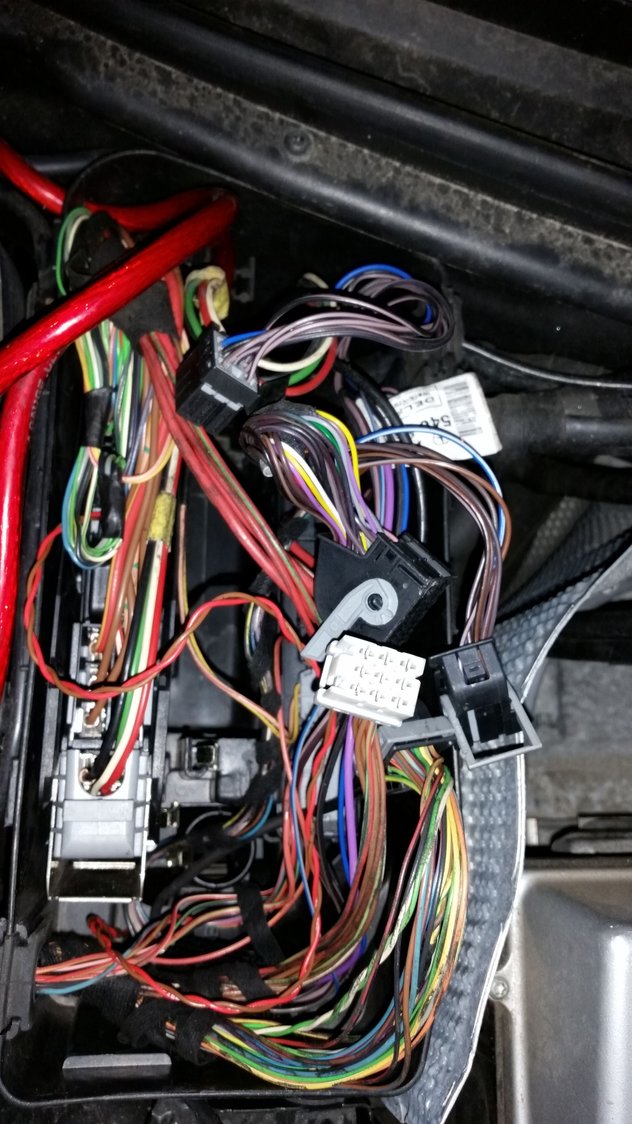

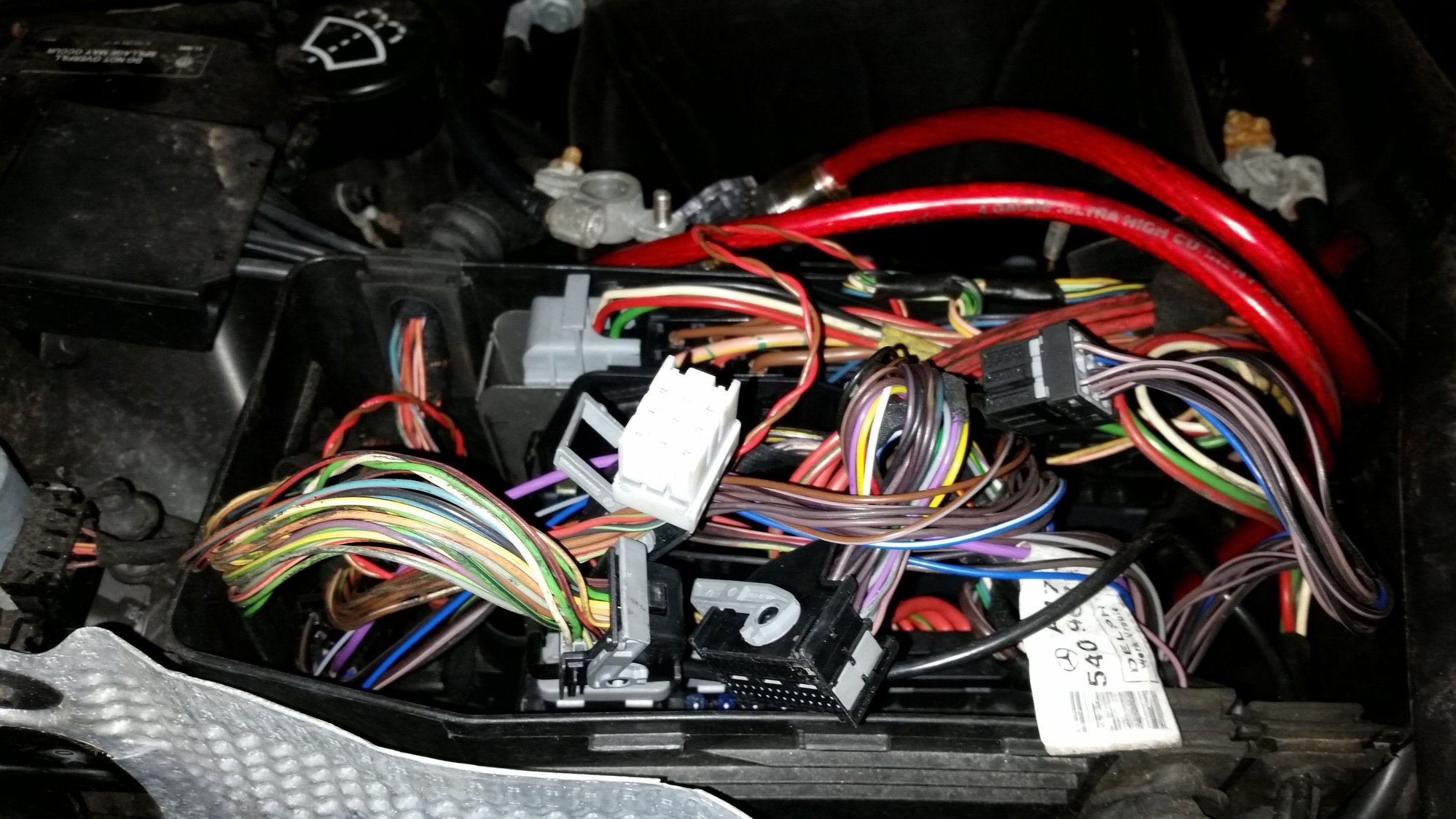

Old Dec 4, 2018 | 02:17 PM
DavieBoiii's Avatar
Joined: Dec 2018
Posts: 23
From: Sweden
Default Re: What part number pease help me out
Here is the photos I just took.

I think I have found the right part number. And I also think it is the PCM that is missing in my car but I am not sure. Need confirmation. I will buy one from eBay and reflash it.
