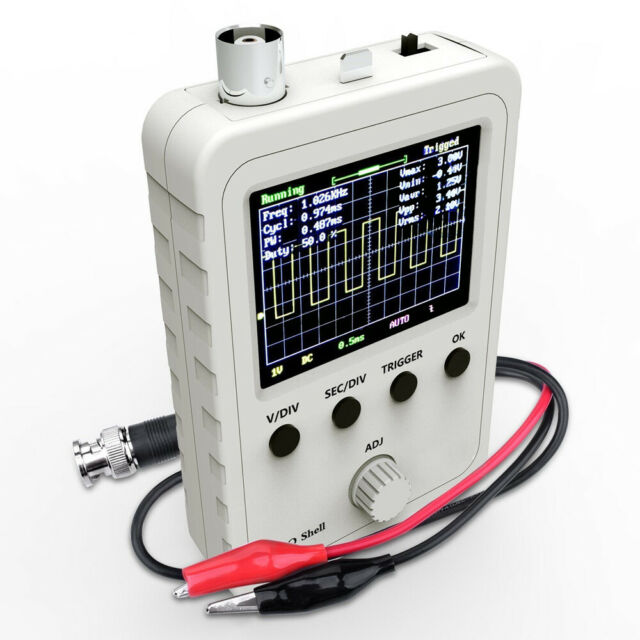

2 possibilities :
1. the wheel speed sensors ( get a cheap digital Oscope off ebay and have a look at the signals at the antilock btake module ( it communicates with the BCM via CAN bus )
2. The speed sensor in the transmission. This I don't know too much about, I know it feeds the TCM, and I would assume it would also get to the BCM via CAN bus.
https://www.ebay.com/i/283538347896?...saAt9qEALw_wcB

Hello again, its still wings up at around 40 mph so I will order the https://www.ebay.com/i/283538347896?...saAt9qEALw_wcB tonight. . Is this something that I am going to be able to figure out? This is the first car where I had to buy 2 scanners/readers in the first month and I may be in over my head. I really enjoy the car and only hope it is not something to do with the trans. thanks for the help.

Can you please tell me this is the same unit, it is from a USA seller and will get here quick. DSO-Shell (DSO150) Oscilloscope Full Assembled with P6020 BNC Standard Probe US! flea bay item 202659748198. thanks (OH NO ! This is not going to be my conductor plate is it?) This all started when it shifted from 3 to 1 . This is not good is it? How long do I have Doc? I did check the fluid and it was clean and fresh. 45mm at 145 degrees. I made my dipstick out of a motorcycle inner cable, the parts store wanted 20 bucks!

Yup, that's the one. Nothing like the feeling you get driving around knowing you have an Oscope in your kit and no one else does
shifted from 3 to 1
supposedly, the 722.6 tranny won't let you harm it, the TCM knows the game and won't let you cheat.
( and if it turns out that the "speed sensor" is the culprit, that IS the conductor plate. )
