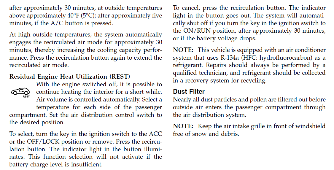

The fan is wired to battery B+ because of the REST feature, the thing that uses residual heat energy from the engine to keep the interior warm while you are in the bar ( pub ) having the after work toddy.

REST also helps when broken down in the most extreme cold (hopefully in time for a rescue?). Although I would agree keeping the car warm while having that ONE 'on the way home' stress relief. LOL

I've been wondering for awhile why Residual Engine Heat Utilization is abbreviated REST. I couldn't find it in the forum.
The best I can find is the German word: Restwärmenutzung which according to google translate means "Use of residual heat".
