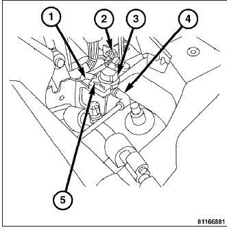

Originally Posted by mariontr
Thanks Toolman and pizzaguy and if it was the purge valve is that easy to replace? Location I would assume is in the engine bay? I did order a gas cap and yes will inform the forum if that did or did not fix the issue.
Under hood, driver's side, Item 3:

OK, changed the gas cap and decided to look for the purge valve as indicated in the diagram and noticed that the hose connected to the purge valve has cracks in it and that may be causing some of the problems. See attached pic of the hose. Has anyone changed these?
The purge valve and cracked hose
