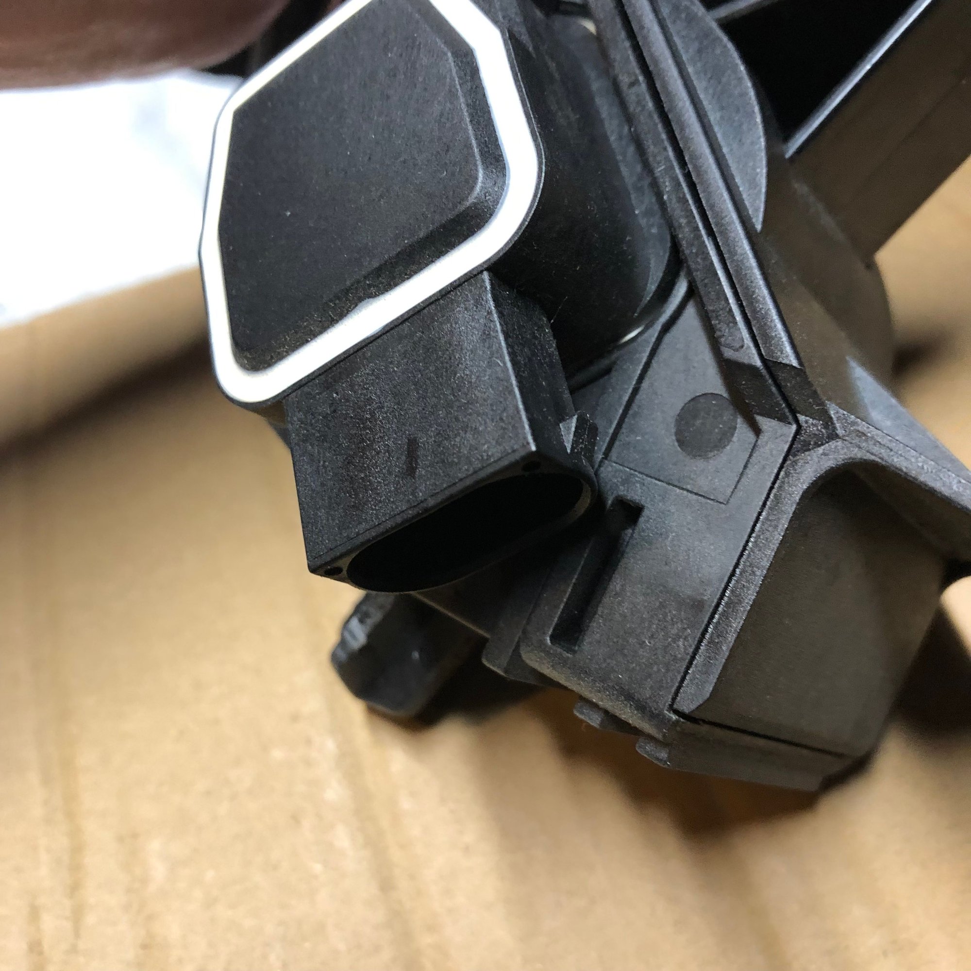

It’s been a while since I replaced mine so I can’t remember how exactly to remove the connector. However here are some pictures of the pedal that I replaced, maybe it will help to see where the latches are.

There a video on YouTube. It might help. Just look up crossfire pedal replacement

Ears on both short sides then. May just not able to squeeze hard enough. Will keep trying. Thank you.

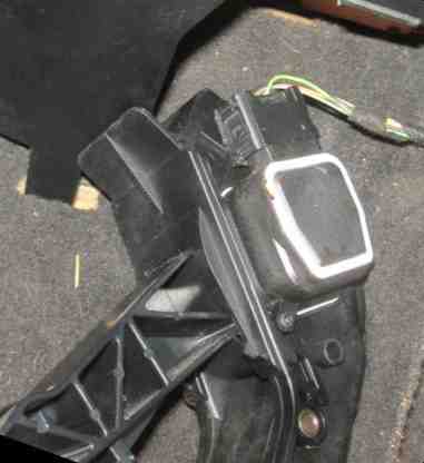

Well got the pedal off with one casualty (see pic), ziptie moment ? No-one (including service manual mentioned the second connector (lower arrow) , anyone know what it is ?
ps 2nd connector seems to be a momentary contact when accelerator is floored. Kickdown switch ?

If you have an automatic transmission then yes, it’s the kick down.
