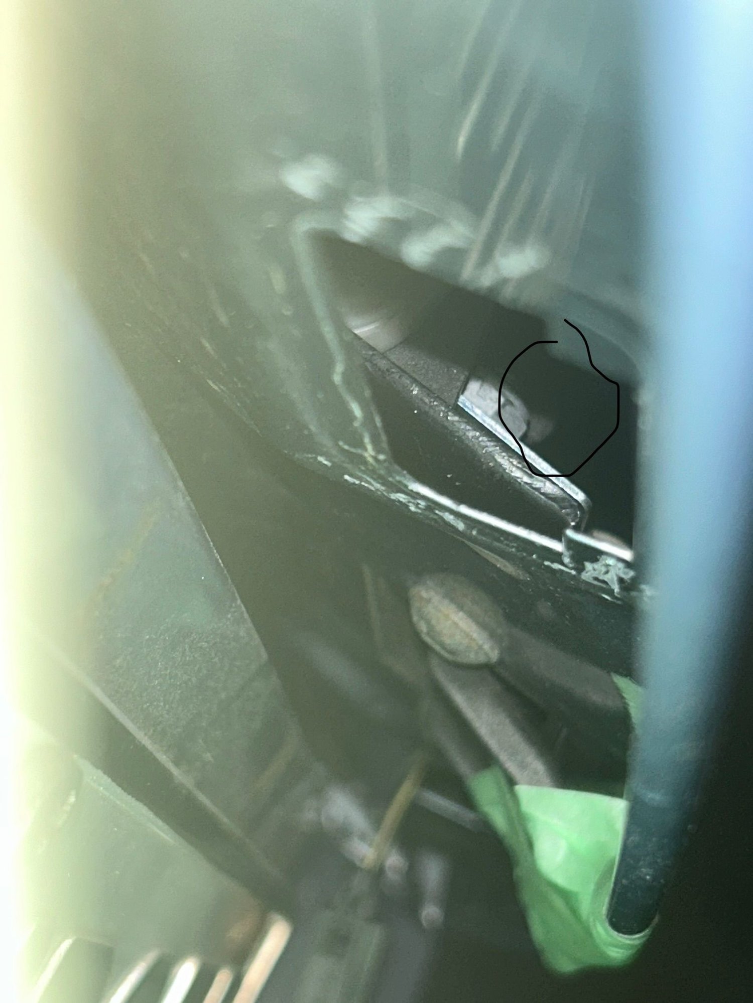

The past few months my central locking has been playing up (due to water in the boot) now I am needing to open my boot to get to the central locking module. But I can’t get the boot open no release hatch from the inside, I can’t release the lock hatch from inside the left license plate light hole, the fob does nothing die to the central locking module most likely being under water.
does the method from inside the left license plate light work if the central locking is dead? If you manage to flick it up does it make a “click” sound if done correctly?.

photo above is take through the left license plate light socket where I am trying to move the lever with no success of opening the boot

Solved. I needed to push the lever on the inside at the base of the pawl. Credit to :magredvet his pdf helped make sense of the mechanism. Now on top opening that gas flap
