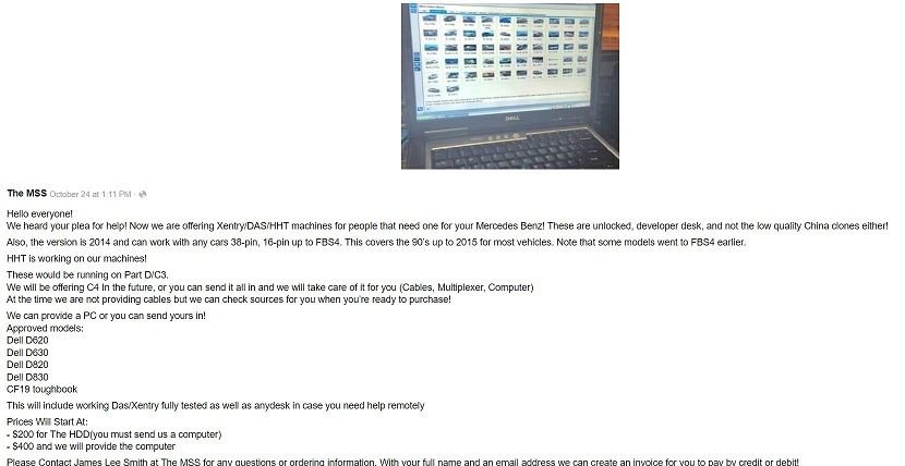

"Pizza's Brain Trust" says:
I think his best bet is to buy the computer setup that The MSS is selling.
Here is their announcement:
@GannyX on this forum is James - you can contact him here via PM or at: https://themercedesswapshop.com/
