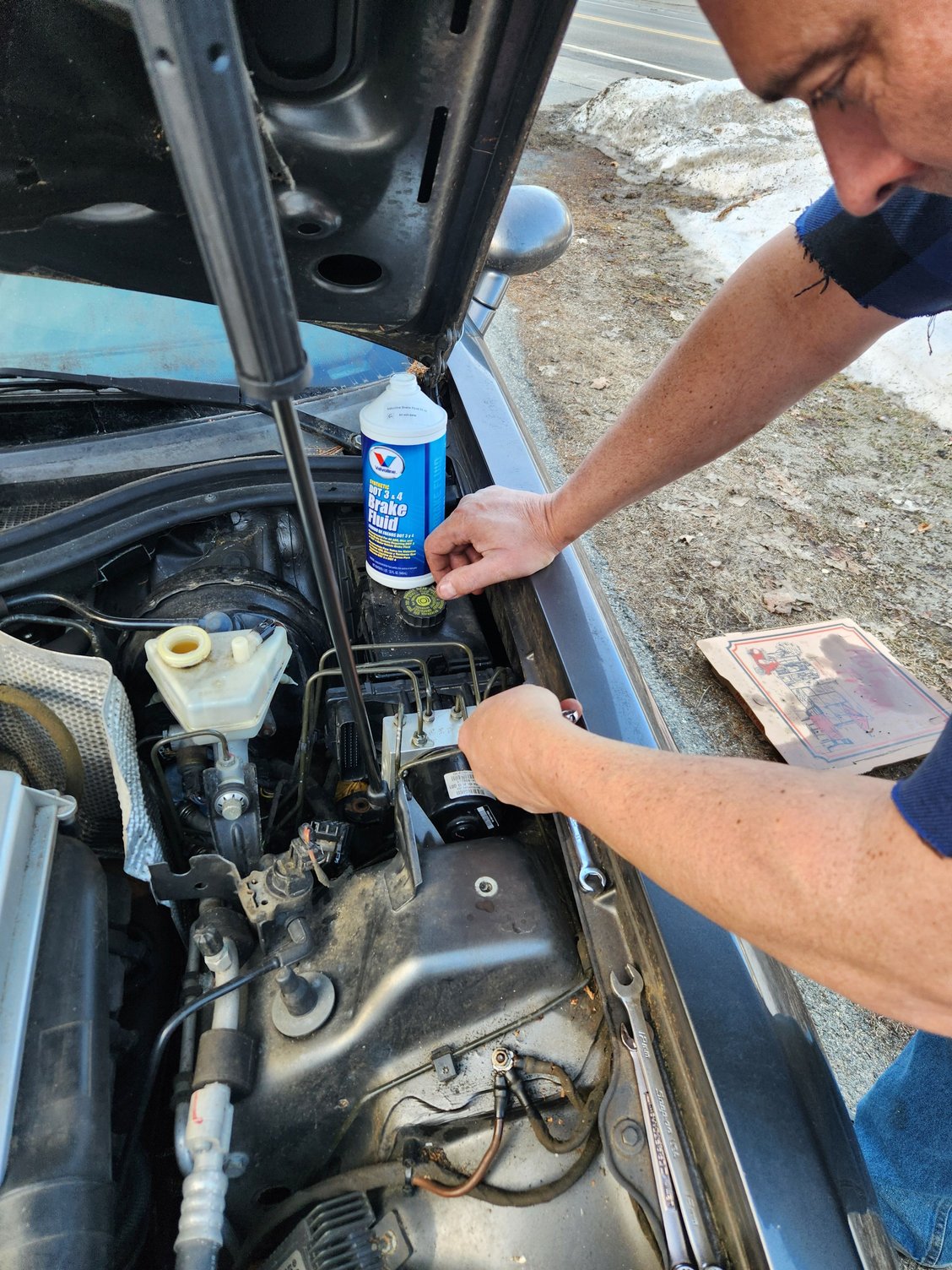

Well, he fixed it... because of course he did!
Last time she started up, she wouldn't shift out of first and the speedometer didn't work, along with some random errors.
He replaced the abs module and bled the brakes, then cleared all the codes.
For the first time in years the spoiler went down and stayed down on its own free will!
We drove it down the street, stopped and checked it over before deciding it was ok to go around town to let the engine warm up and stretch.
There's a random sound like we're driving over rumble strips once in a while, so that's next on the list to review... something about transmission mounts or drive shaft things. He said a lot of words.

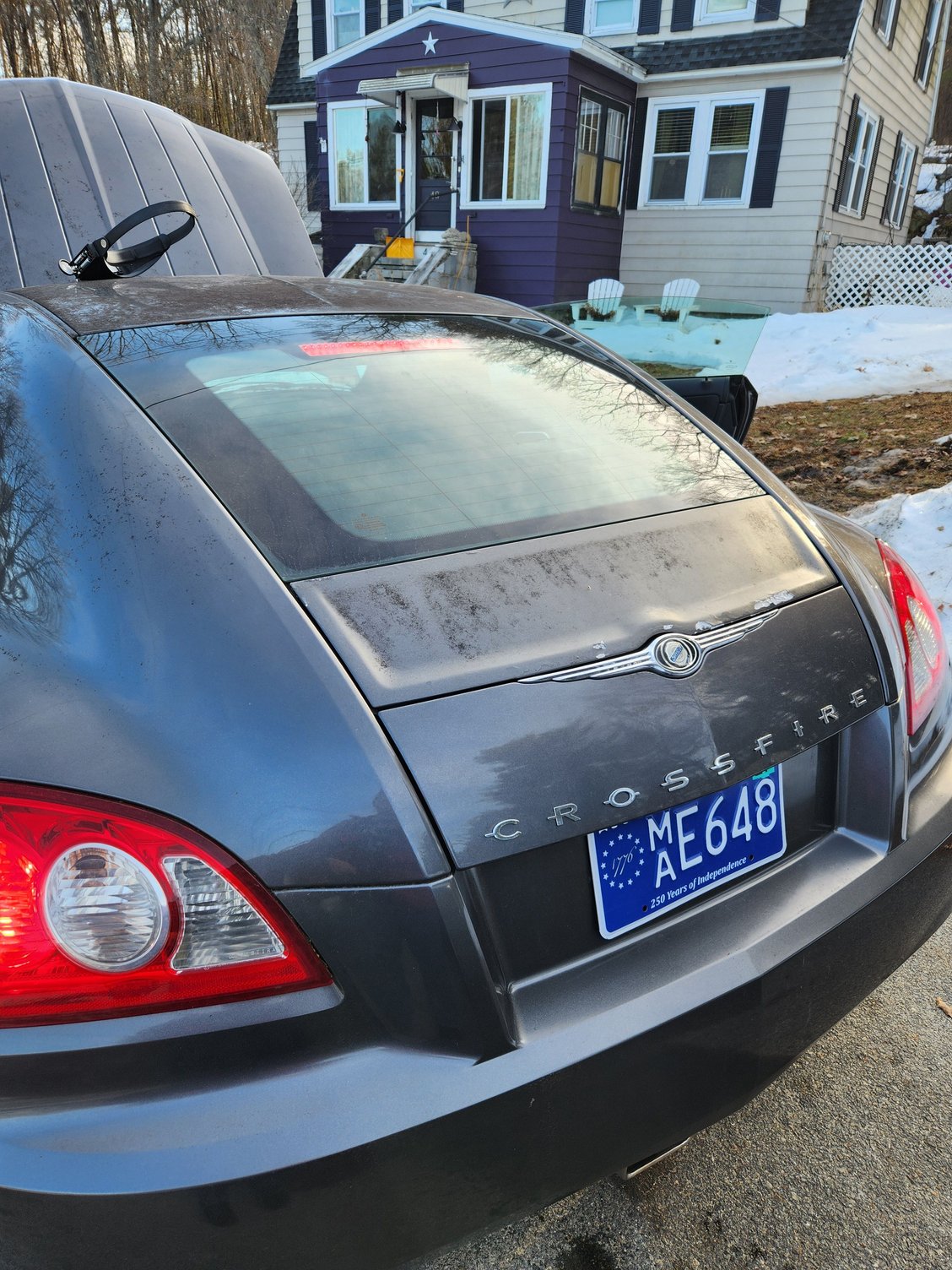

So far so good with the restoration. She's driving fine, with the exception of the minor rumble from the transmission once in a while (we did the flush a couple weeks ago and I've only taken her around the block a few times). As the warmer weather in New England is fluctuating, I've noticed the rear window has been fogging up from the inside consistently. All the internal panels are still out, as we plan to hose her down pretty well to get any remaining mouse evidence out of the nooks and crannies. I thought maybe the dampness inside is from everything (but the seats) being out, but I think it might be something else.
Are there drains in the hatch I should check for or can the gasket be replaced? Perhaps issues with the seal around the wing? Just spit balling.

There is two rubber plugs either side of the hatch bottom towards the front of said wells, under the foam (if foam piece is still there). Many members poked a hole or cut a big piece out of each to drain if it leaks into there. Good luck with your project!

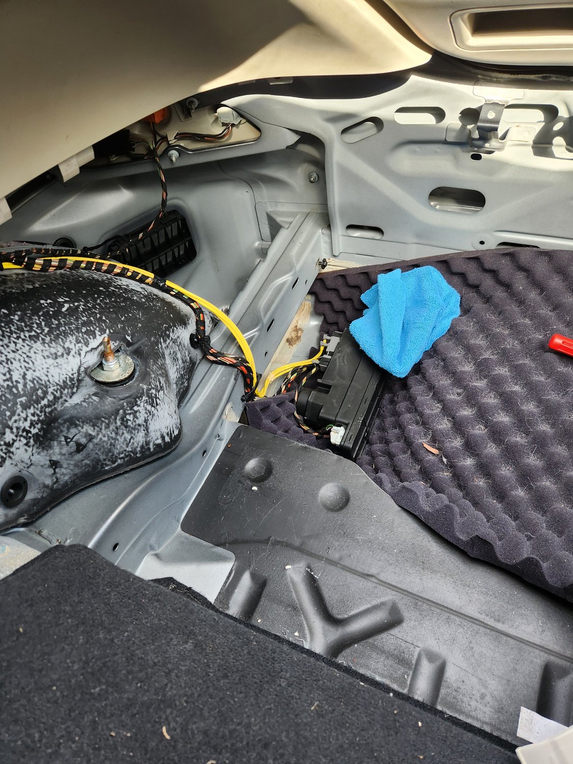

Can someone send a picture of the trunk guts, so i know how to place the black box? I need to build a new foam holder as the mice destroyed mine.
Also, are these the drain plugs and are they expected to be a bit rusty? Should i spray with some rustomeum?

Misty, I would scrub that debris with a stiff non-metallic brush & strong cleaner before deciding to paint. It looked to me it might be crud stuck there. If it is rust, you'll have to mitigate the growth of rust (I have NO EXPERIENCE with rustoleum paint). but if there is any dirt/mouse crud it should be removed. Good luck! .

The small black plugs are the ones that you need to remove. One in each trunk well.

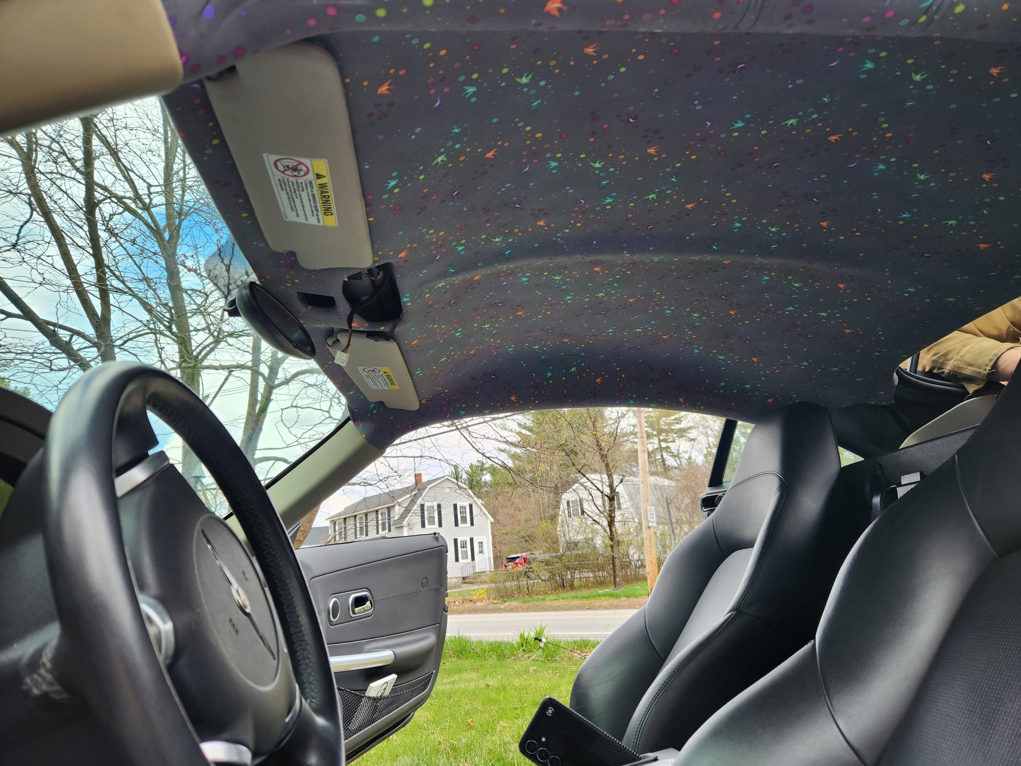

Well, got the headliner redone and installed. DEFINITELY not my best work, but it's glued and will do the job. I'm a product of the late 80's, so i think it's perfect. It does make it feel a little short in here, but if i hate it, I'll do it again.
Where i think I failed was prepping the holes. I think the outside hole I cut might have been for a different model spec because I don't have any parts left in my bin!
Also still fighting with the stupid back plastic panels. What a nightmare... I'm taking a break by trying to put the stupid e brake cover back on. I'm sure there are a lot of jokes that are fitting here, but I'll keep them to myself.
