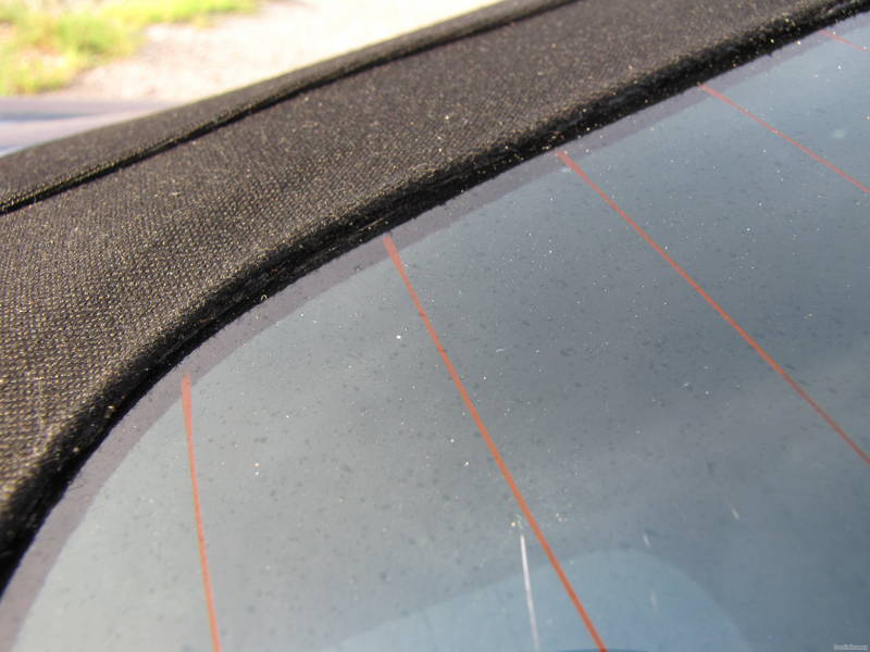

Originally Posted by tighed1
Wow! Must be summer time with all of these posts about glass coming out of the tops!
Found out that my glass was separating also. So far I have...
  • Moved my PRETTY 65 Chevelle SS out of the garage (sorry Baby) so I can put the Roadster in.
  • Bought a car cover so I can cover the car while it is outside at work.
  • Repaired the top with 3M Window-Weld (08609). So far so good!
We are in our monsoon season now so I will probably drive other cars until I am sure I will not get caught in the rain.

Originally Posted by Stevefromtyler
...I am going to try this 3M stuff tomorrow... Is your repair still holding up?...
Yep! Been three weeks so far. Looks like new! Top goes up and down everyday. Holding up GREAT!
Did a sort of How-To on this thread https://www.crossfireforum.org/forum/crossfire-roadster/35371-roadster-rear-window-problem.html#post396080
Just finished about an hour ago, and I was real thorough in the prep, and though the stuff is hard to keep from sticking to everything, managed to get it on all areas of window without a mess on the canvas or car. It does seem to be the ticket, and the nature of this stuff being somewhat flexible, makes it removable if another repair is necessary down the line. I will let everyone know if my repair is successful down the line. Thanks for the great post on this repair. STEVE T

Hey Steve,
Your repair looks EXACTLY like mine!
Good work!

Default Re: roadster rear window stick-up
If you just used standard black silicone you are going to be dissapointed. Use the good stuff, 3M Window-Weld (08609). Did my repair a month ago and it is still holding perfect.
I used Permatex part #81158 black silicone adhesive sealant. It is different than the 3M Window Weld part #08609 which is a urethane sealant. 3M recommends their product is used to seal primered (3M product) glass to painted car bodies Also they recommend that the orig. sealer not be totally removed(!). Permatex claims their product secures windshields, vinyl tops, metal etc.. I have used Permatex products nearly 50 years with satisfaction. I used what I could find. I came across the Crossfire forum after my repair had been completed.
