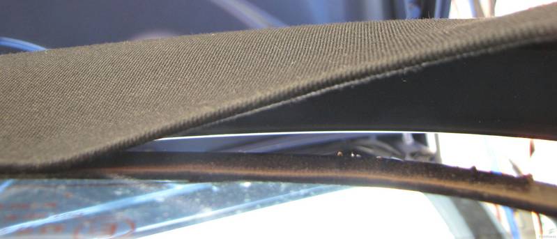

Dang! You guys make me look.
Look what I found today.
If you look how the top folds when going up or down you can see where it stresses the corners of the window seam. Don't see an easy fix. Silicone isn't going to hold it. Need something stronger. Maybe Gorilla Glue?
Ideas???

Might as well post this here also!
Wow! Must be summer time with all of these posts about glass coming out of the tops!
Found out that my glass was separating also. So far I have...
  • Moved my PRETTY 65 Chevelle SS out of the garage (sorry Baby) so I can put the Roadster in.
  • Bought a car cover so I can cover the car while it is outside at work.
  • Repaired the top with 3M Window-Weld (08609). So far so good!
We are in our monsoon season now so I will probably drive other cars until I am sure I will not get caught in the rain.
Coming up on three weeks and the fix is working. (now over a year, still holding)
Hard to tell that it was ever fixed (I do good work).
If you go this route be careful spreading the WW08609 around. Its sticky stuff.
How I did it.
  • Bought the WW08609 from Autozone for around $18 +tax.
  • Put the window in a straight up position so there was slack in the canvas.
  • Used a razor blade to remove old glue from window.
  • Punctured end of WW08609 tube and squeezed the glue out since I don't have one of the fancy guns that this type of tube requires. Also didn't need much. One tube could fix a dozen tops easy. I resealed the tube with plastic wrap for future use if necessary.
  • I used a small blade screwdriver to spread the glue onto the glass where it makes contact with the canvas making sure to get into the tight areas where the top and glass are still holding together well.
  • Let the glue tack up for a few minutes then put the top UP all of the way to include latching the front latch. This will pull the top and glass tightly together. Carefully press on the repaired areas to ensure a good seal. If you need to support the glass from the inside.
  • Now LEAVE IT ALONE! I waited till the next day and used the razor blade to remove the excess glue from the glass.
Looks like new!
Yer welcome!
