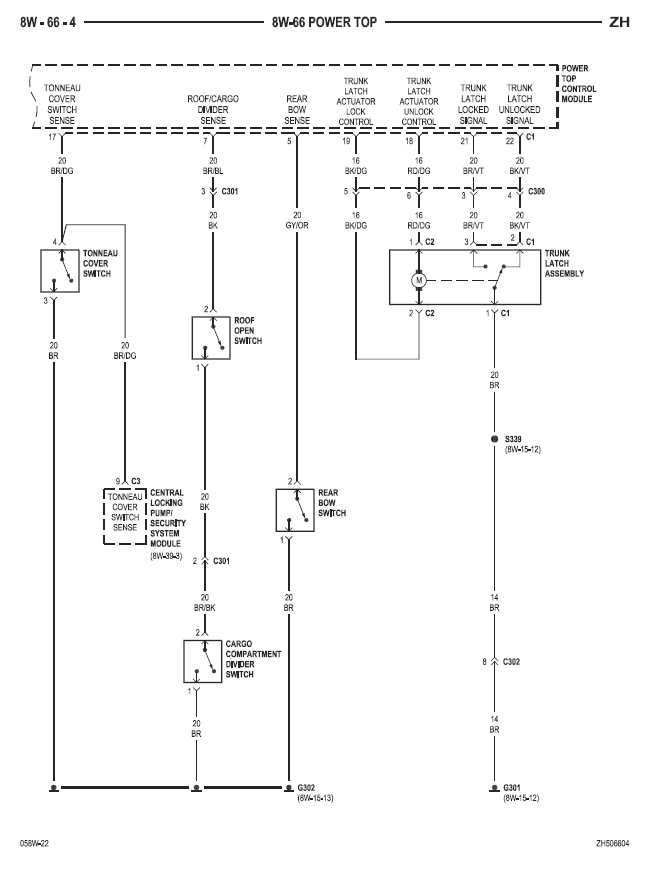

I must routinely have to get out of the car and slam my trunk lid down a couple of times to get the convertible top to function. I removed the inside cover where all the switches and gizmos are and everything appear connected. It's beyond aggravating and I would appreciate any suggestions.

The only thing I can think of that might be affected by slamming the trunk lid would be bad contact in the trunk divider switch. Have you tested the switch or tried bypassing it by taping it shut or ??? It is there to be sure you don't try to lower the top with something in there that might interfere with it's movement.

There is also the truck latch switch, a much more likely suspect than the trunk divider switch

I didn't realize the trunk latch had anything to do with the top operation?
Old Jul 30, 2017 | 05:21 PM
Default Re: Coverible Top Problems
It shonuff do :

If the trunk is not closed, and does not STAY closed, the toneauu lid will collide with the spoiler and/or trunk lid when it raises to allow top movement.

The trunk latched switch can cause this problem. Remove the cover on the deck lid. Look for a connector going to the trunk latch. Disconnect the connector. If the top works, the problem is the trunk latch switch. Seems reverse logic is at play here: if the switch is open, the trunk is latched, the switch is wired so that it opens the circuit to ground when the trunk is latched, the latch keeps the switch open when the deck lid is latched. Problem is that the deck is latched most of the time, therefore the switch lever is depressed. Time causes the activation lever on the switch to bend and ultimately it will no longer operate the switch, thus the switch never opens and sends a signal that the deck lid is not latched.
Confused?
Just disconnect the connector, if the problem goes away, you have found the cause. A simple mercury switch installed so that it is closed when the deck lid is open will solve the problem and will insure the top is inoperative when the deck lid is open.
I checked 4 used latches and they all had the same switch failure.
Good luck.
Mercury switches might be OK if you always parked on a consistently level surface. They can be quite delicate when set but if they are not in the same plane as when set they will give false readings and a slightly ajar trunk lid could be read as fully closed. Micro switches can be set like a hair trigger and work at any angle but the quality of the switch must be good to repeat the settings, and the contacts inside must be of good quality as well.
