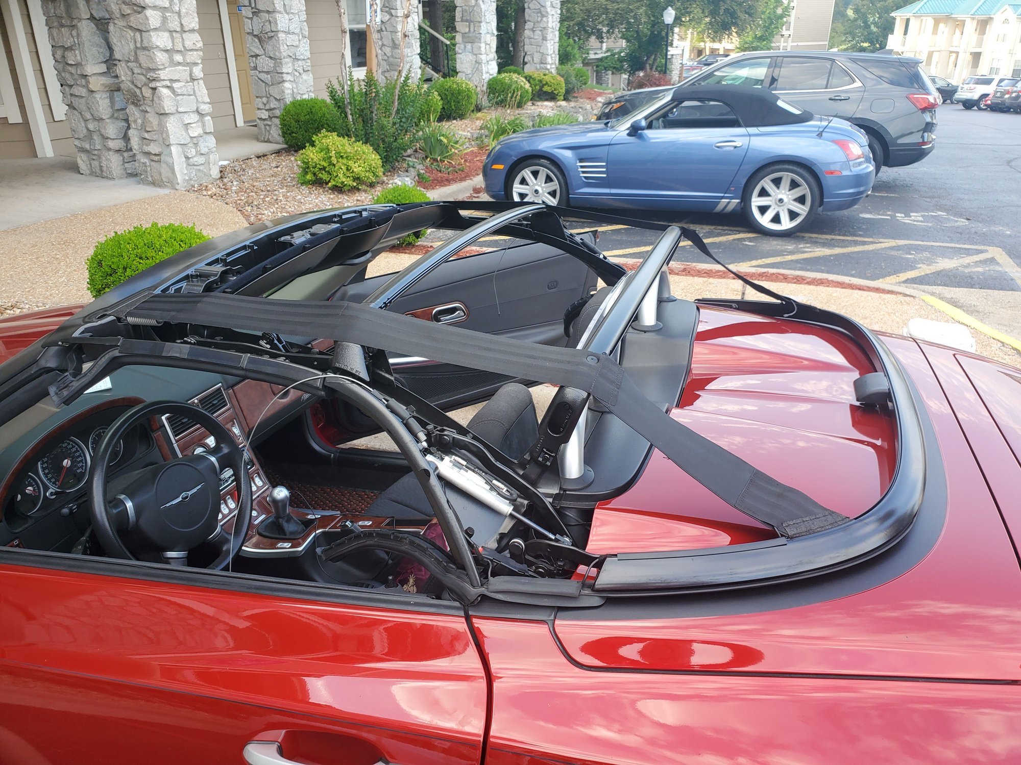

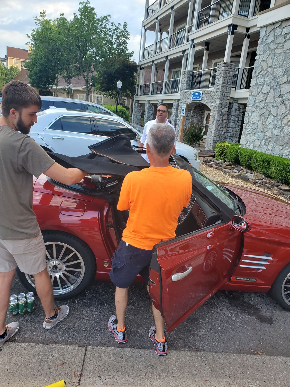

You took the car to a dealer. They performed lousy work. No big surprise, READ MY SIGLINE and do not EVER make this mistake again.
Replacing the top is easy, but dealers cant change oil, they sure can't handle a new top.
My top was replaced in 90 minutes, in a condo parking lot, by forum members. Yes, we did what a dealer can't do, in a parking lot, in 90F heat, in 90 minutes.
