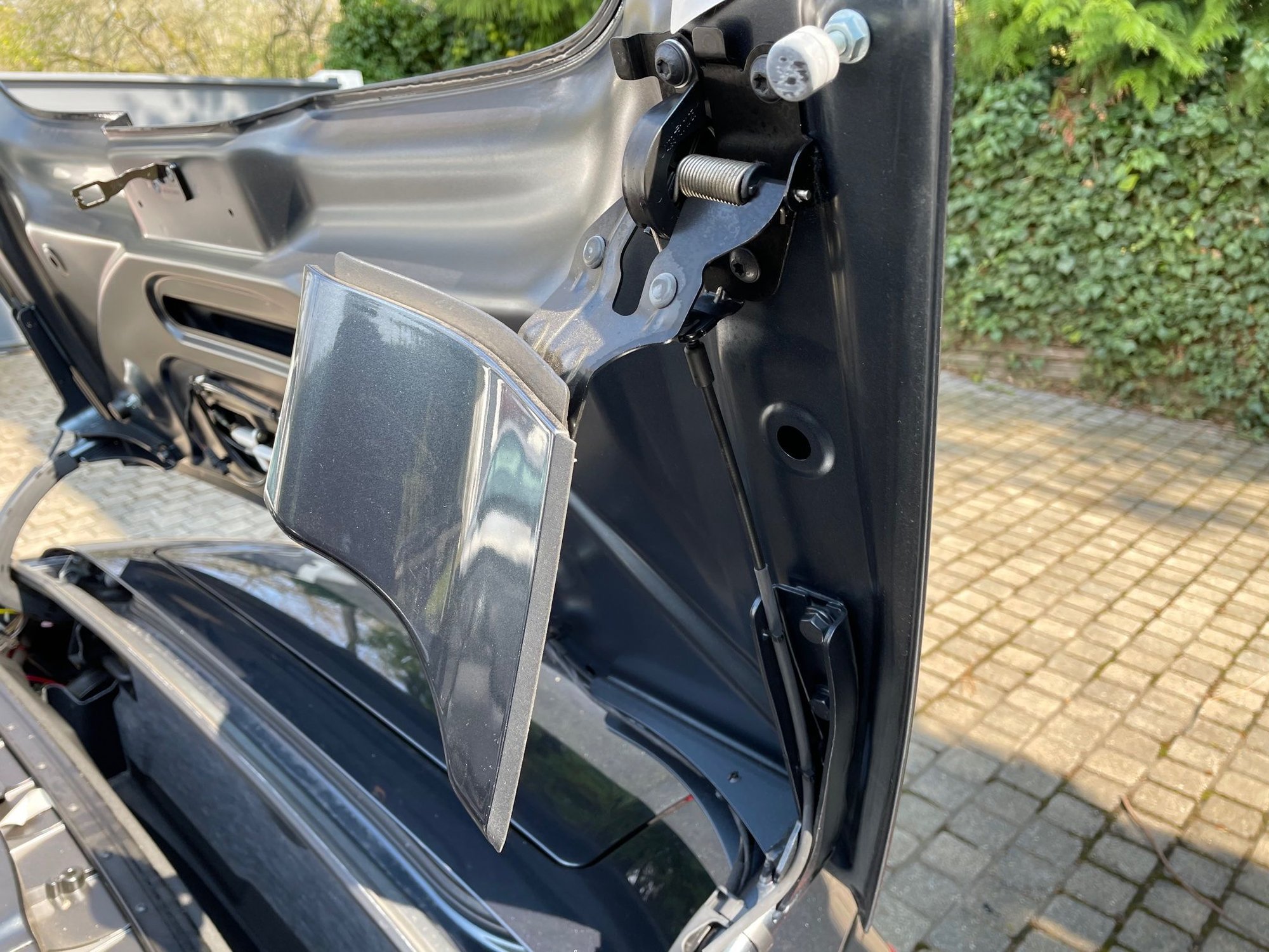

Hi guys,
I need your help with my crossfire roadster, the flaps should move up and down but they don't. The stay down.
I checked the cable and they seem ok.
I guess the cables need to be tightened ? But where ?
Thanks you so much
Old Apr 14, 2021 | 11:52 AM
danao91's Avatar
Joined: Jul 2020
Posts: 6
From: france
Default Re: Issue with flaps - Help !!!!
Hi Guys,
Just to be clear on my previous post :
- When I close the roof, the flaps move down and everything is ok
- When I open the roof, the flaps stay down and I need to move them up manually.
What do you think ?
Thanks

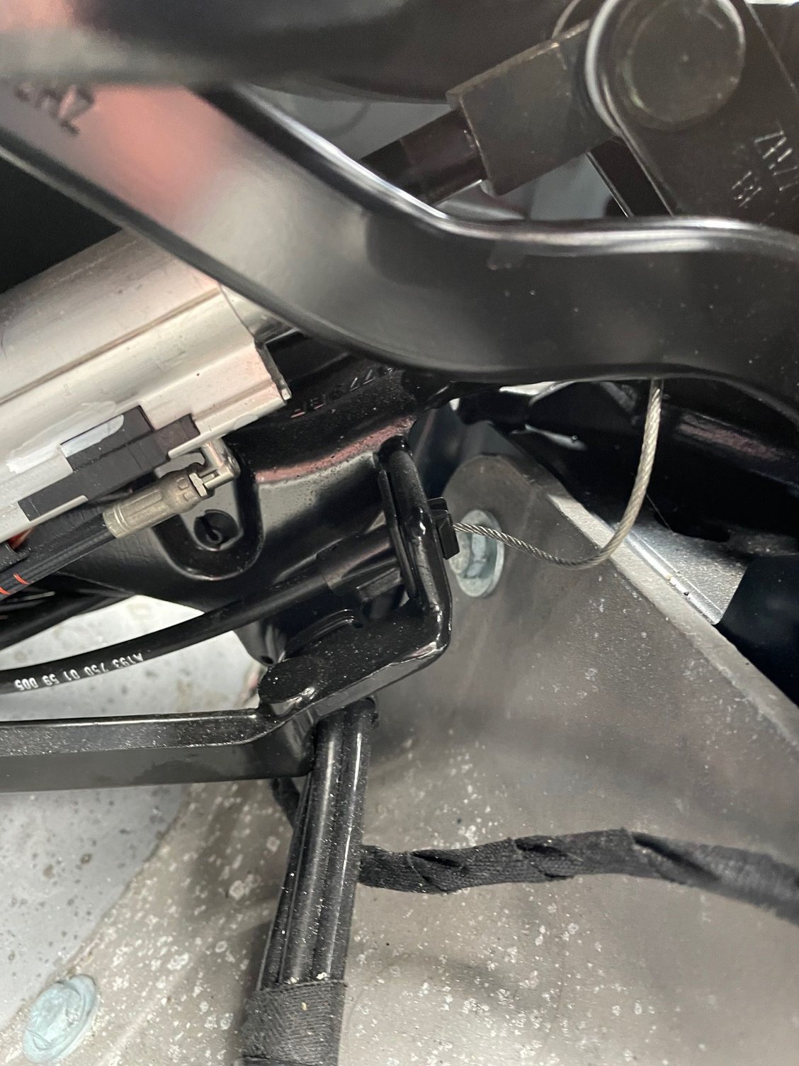

Thanks Pizzaguy,
I checked and you're right the issue is at the far end (not the flap end).
When I open the roof, the cable should go up in the sheath in order to move up the flap. Instead of that, the cable remains soft.
As you can see on the picture. What do you think ?
What would you do ?
Thanks
