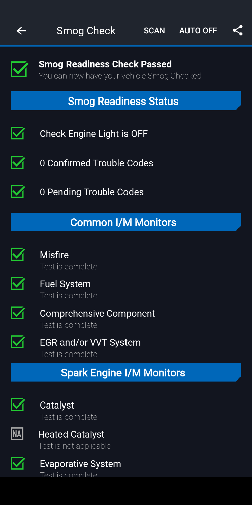

Trial and error is the hard way to solve this. As I also have two Crossfires with very low mileage I have to watch out for bad gas clogging things up and causing misfires or worse. What needs to be done is to use a good scanner that not only reads error codes causing check engine light to go on, but include OBDII readiness monitors (smog check). I suspect there was a repeated failure related to the drive cycle tests. Buy yourself a decent scanner. I've lost count on how manner scanners I've aquired over the years for different reasons, and at different price levels. I've seen many other posts with forum members recommending their scanner of choice.
A quality low cost and easy to use scanner that provides a lot of good information is the BlueDriver available on Amazon. It's very conventient and easy to use through your smart phone.

I've used the BlueDriver on both my 2006 and 2007 Crossfires and it works fine without any special configuration. Last year I replaced both car batteries with AGM batteries. I did not bother to provide alternate power to the car computer to save the OBDII readiness status. That will never happen again. I had to drive both cars through the mercedes drive cycle procedures to get the OBDII readiness for the annual state emissions inspecition that is done with the safety inspection. As is expected, sometimes that takes multiple tries to get a specific monitor to successfully complete. The BlueDriver was just quick and easy to use for that purpose.
Sometime over the next week I will test it on the 2004 Crossfire to confirm it works on it as well.

I have a BlueDriver and it is the best reader I have for finding the status of the emissions readings. We do not have yearly emissions testing anymore though, they are required only when it comes to selling the car along with the safety test.

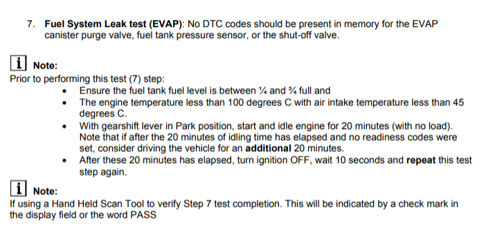

The most common reason for an evap leak error code is a loose gas cap, however, besides a leaking gas cap there are other components that can cause that error. The cap could be bad but I suspect not. A gas cap is not a high priced item. If you are in a hurry to resolve the problem you can buy it and have it as a spare if it does not solve the evap leak test.
Here is part of the Mercedes drive cycle procedures pertaining to the Evap readiness test.

@ Toolman, I just wanted to circle back and say thanks so much for the step by step instructions. IT WORKED. And I returned the cap to AutoZone. Thanks again for your assistance and guidance.
