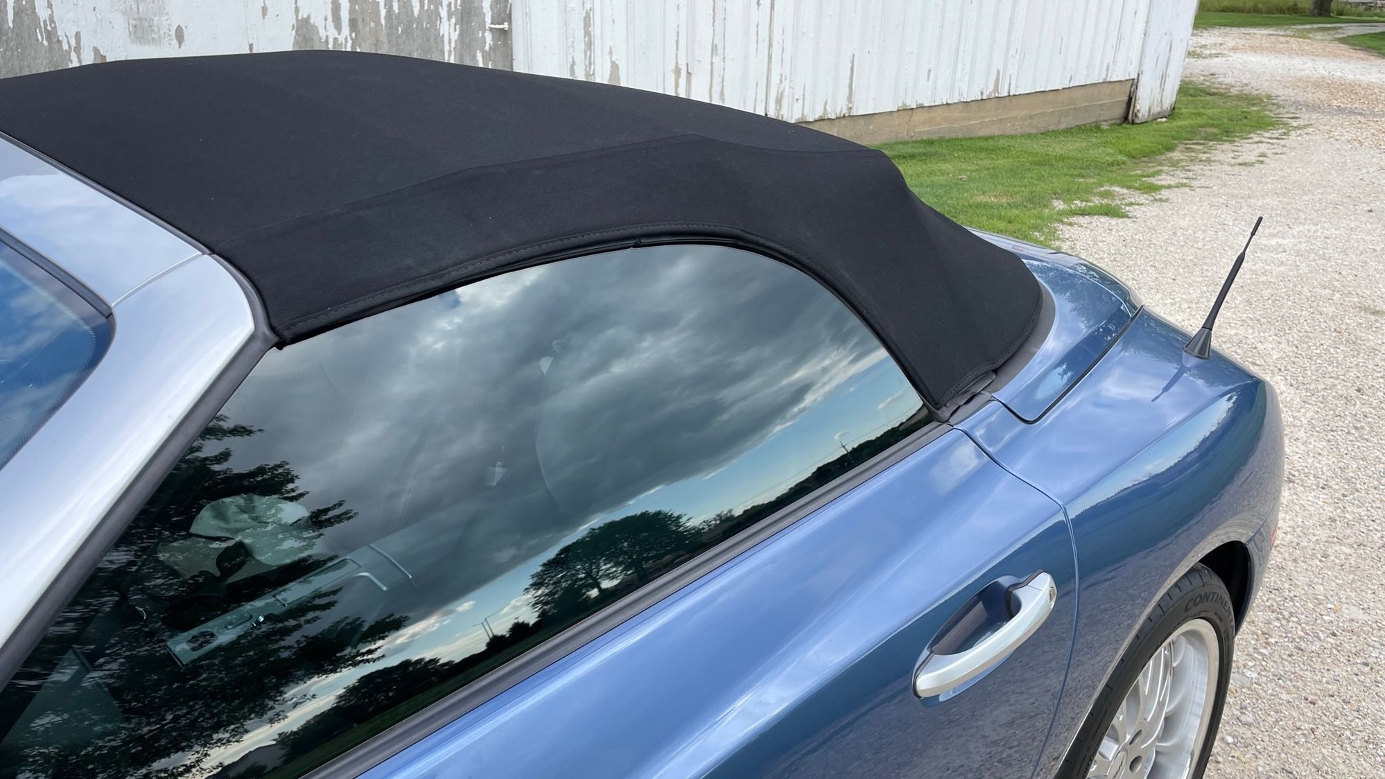

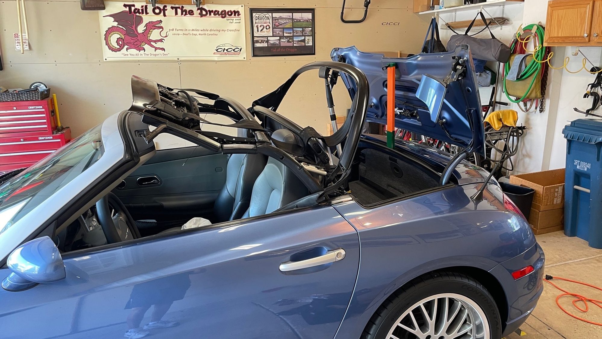

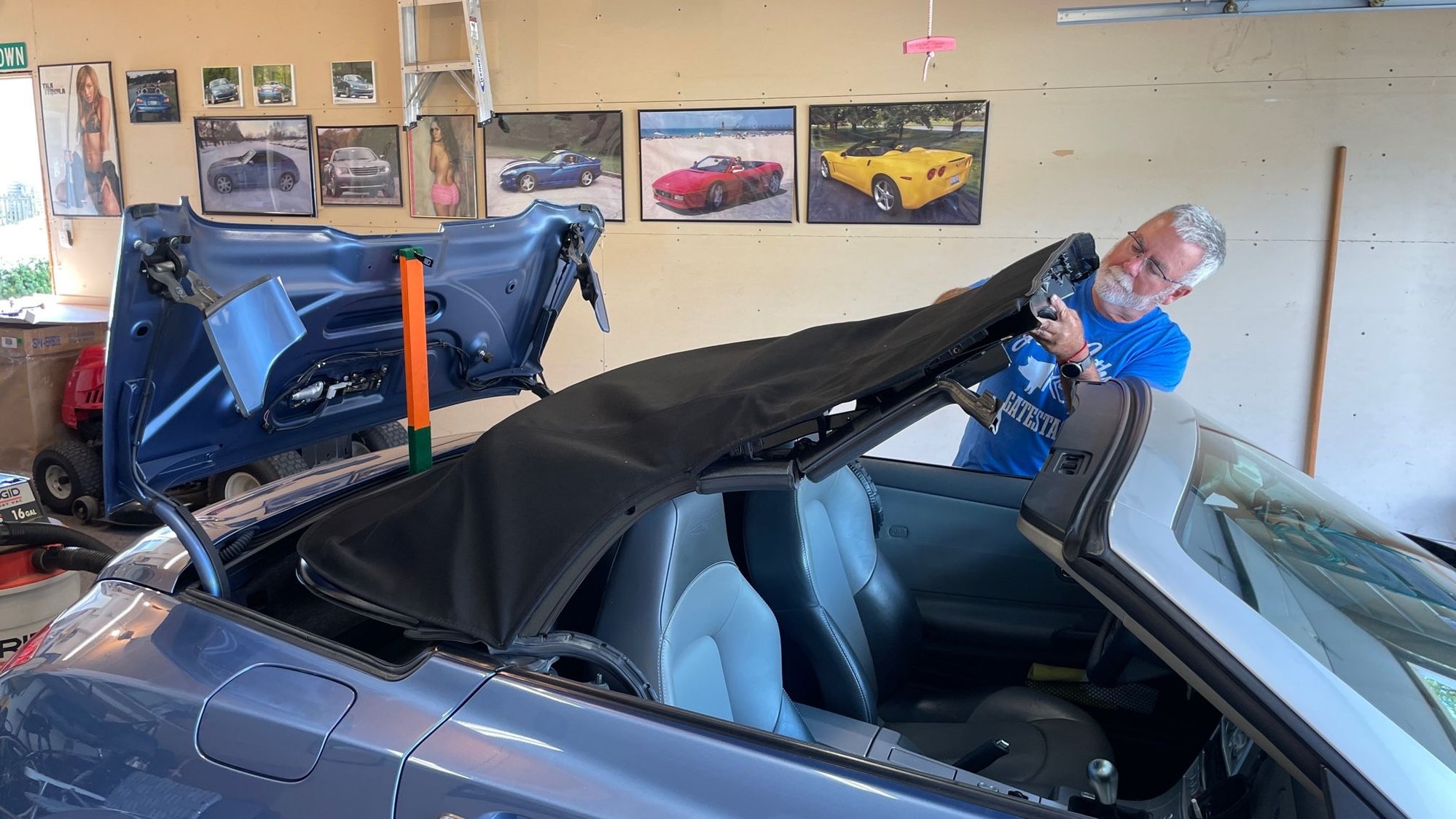

I got my new BAS top installed now

Looking Great !

Very nice! Excellent job!

Again, lets hope it didn't degrade while in storage, like a current new buyer of a preowned crossfire, who has a problem with a recently installed new top the previous owner eventually installed.

New tops are "new"
They are manufactured upon ordering one
6 to 8 weeks lead time
