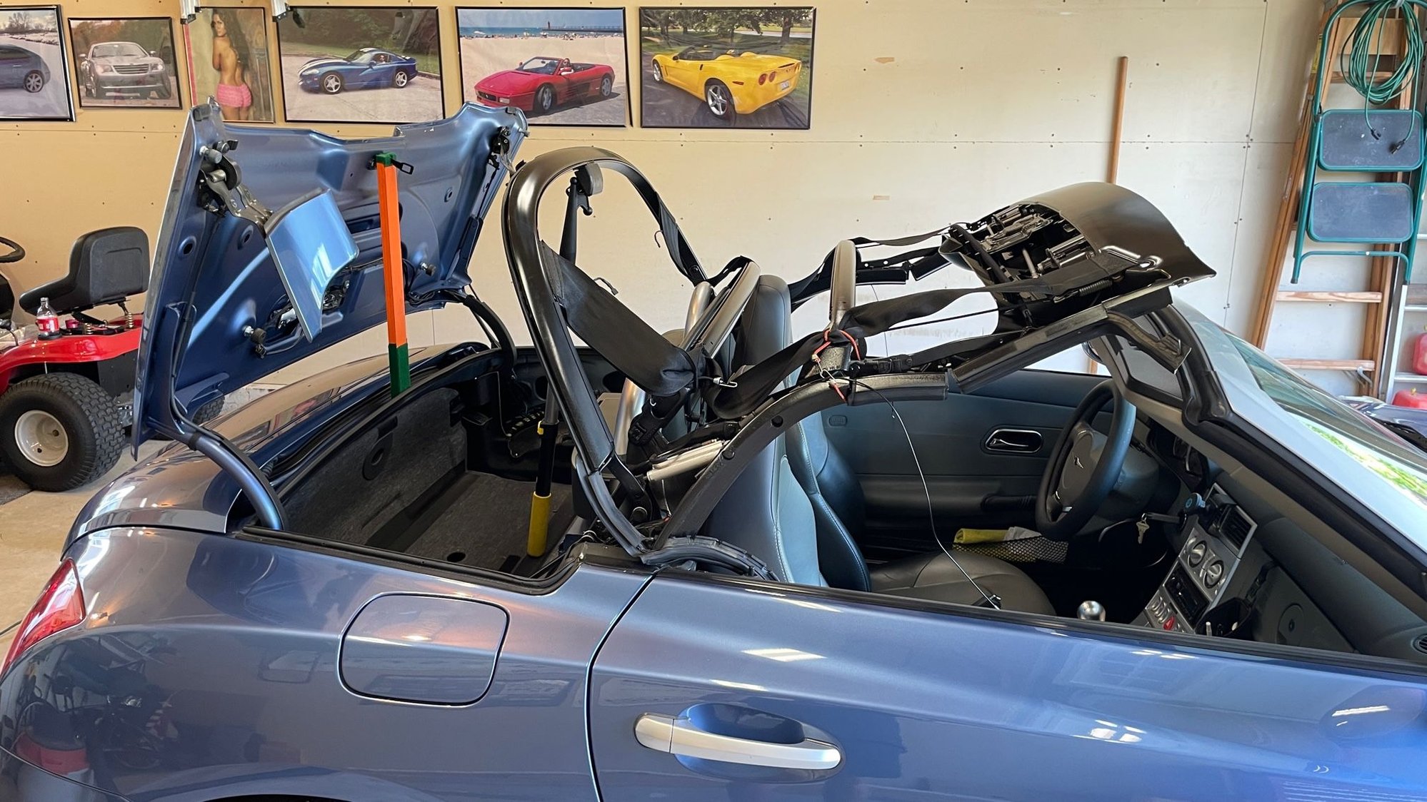

What is that you are using to prop the back cowl? Do the green and orange paint zones have some special meaning to the placement?

3) Green and Orange paint zones? Prop the cowl? I/we don't know what you are referring to.

The “orange and green “, refer to the stick in the picture I was sent used to prop up the rear cowl.
He is referring to the prop board that Robert used to hold the deck lid when replacing my top shown in my post here #6
The colors have no importance on that prop board

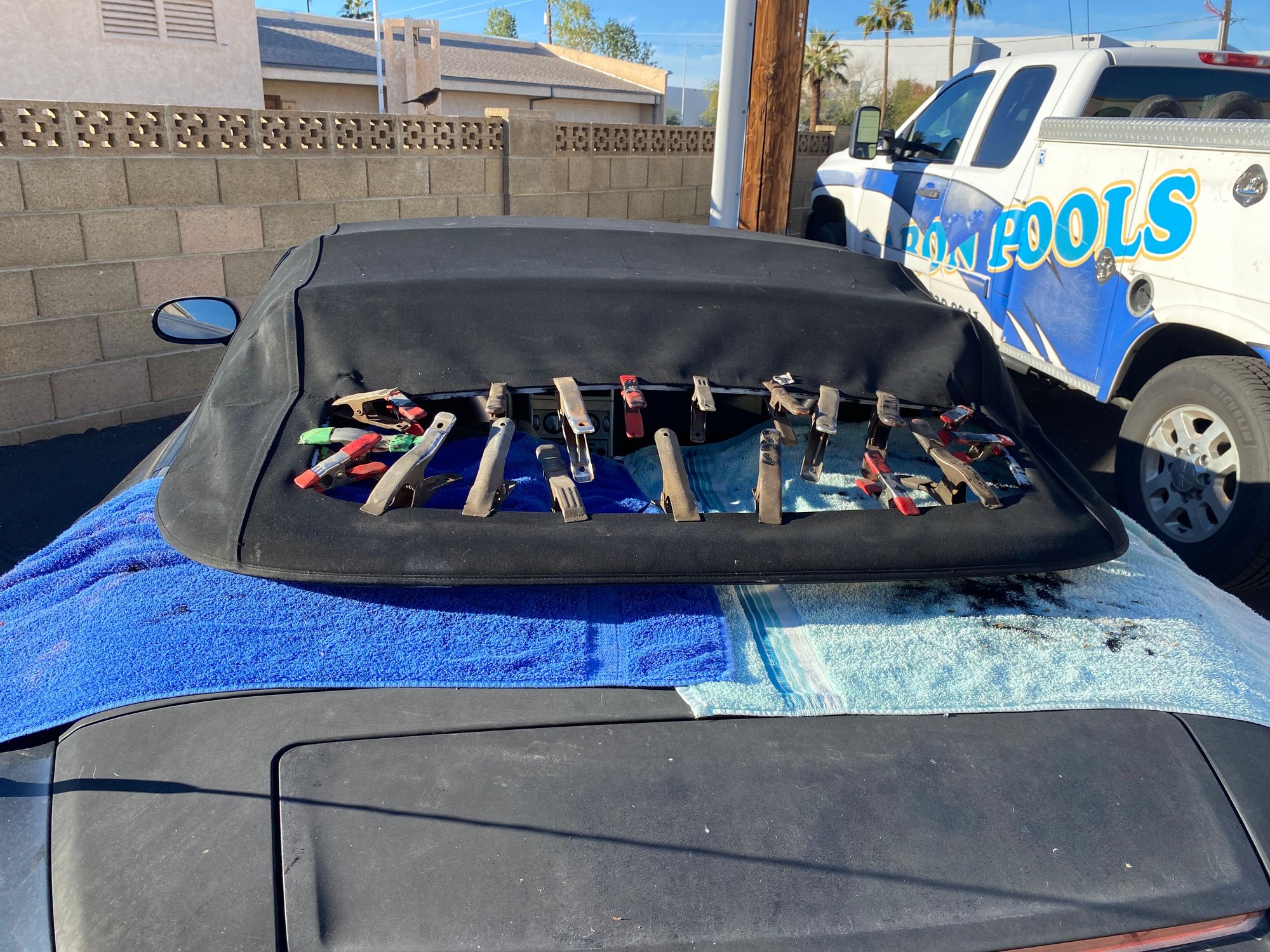

Recently reglued in my back window. While not perfect and quite a bit of work I am happy with the results!

Interesting. The second picture I completely understand because I bought 6 of those exact suction cups. Completely confused by the first picture though. Are those clamps? What are they clamping WITHOUT the window?
