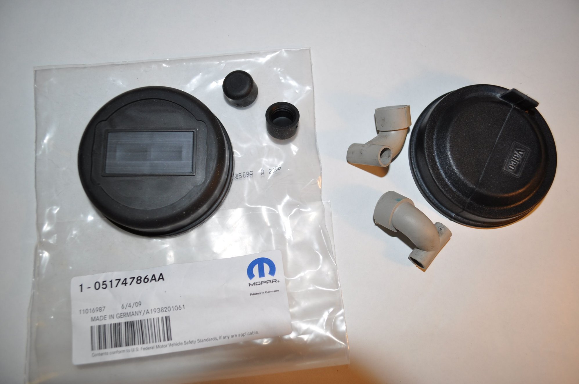

Here is the kit.
On the left are the parts you install. On the right are the parts you remove.The packet came with parts for two headlight units, I show only enough for one.
The secret is in plugging the two holes and installing the large rubber cap which has a filter membrane in it that also stops water from entering the headlight.
The filter membrane stops dust and also allows the heated air to escape, the air also carries out some water vapour keeping the humidity in the headlight unit to a minimum.
Some headlight units were not sealed around the seam between the black body and the lens. I saw one headlight with enough water inside it to keep a goldfish.

Here is the kit.

I did not say you could buy it, I was just following up pizzas post.
It shows the solution and what you would have to do to achieve a solution. The solution is to allow air and water vapour to enter the headlight but not water in liquid form, so a fine mesh breathable plastic material is needed.
I find it works fine, my old covers were converted to fit HID bulbs.
