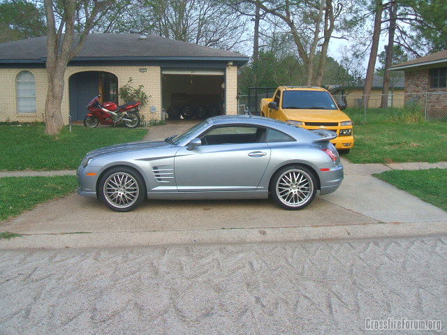

Ok I started working on the rear tonight and ran into a possible problem. I got the driver side out and all apart, went to put the eibach spring in and noticed it is taller then the stock spring by a coil? Is this normal? Every car I ever lowered the aftmarket spring was shorter than the stock. The listed part number on the box is 2552.140 which I believe is correct. The springs themselves say 2552.101 and 2552.102 I guess I'm gonna have to call tire rack in the morning if no one can help.
Old Mar 28, 2008 | 05:05 PM
SRTpowa's Avatar
Posts: 961
From: Shreveport Louisiana/BAFB
Default Re: SRT6 Spring replacement

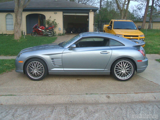

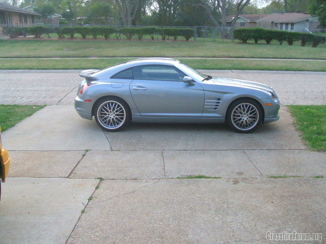

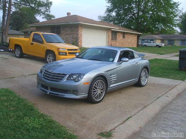

I called tire rack and confirmed spring part #'s. The eibach's are in fact taller when off the car, I guess because they are progressive? Anyway I got the rears on and the car is pretty level. I am going to wait and see if they settle before I do the fronts. Plus I had a real pain getting the lower control arm bolt out and back in on th epassenger side. Eventually me and my neighbor got it, but I hope I never have to take it out again.
So here is my setup:
Stock springs/pads in front
18x8 TSW Snetterton
235/40/18 Sumitomo HTRZ III
Eibachs in rear with #1 pads(thinnest ones)
19x9.5 TSW Snetterton
275/30/19 Sumitomo HTRZIII
Car is dirty and the sun was setting but here are some pics
