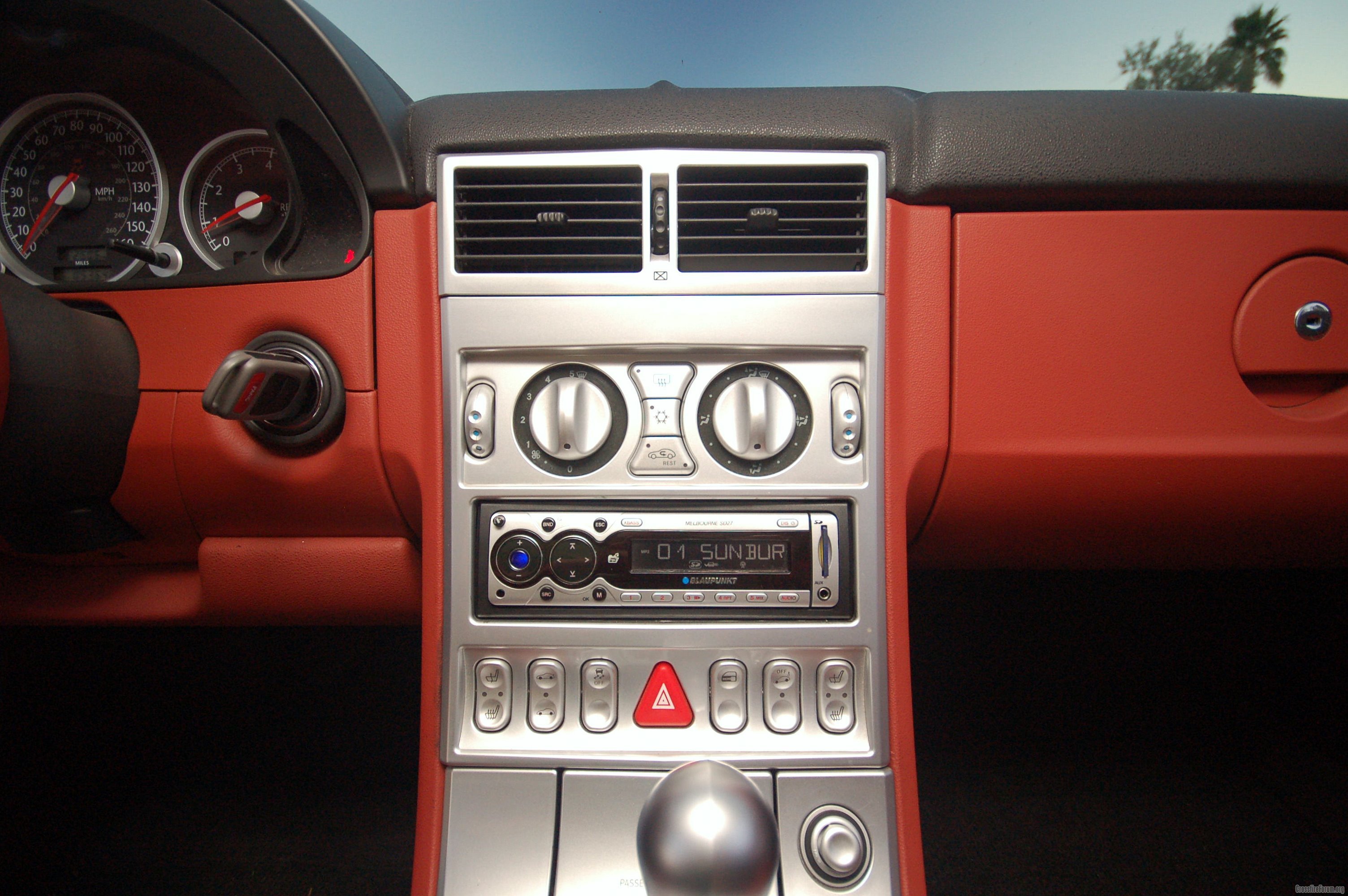

What is that dummy switch supposed to be for? I noticed it tonight. That would be a good spot if I could get one to match.

Just buy another one of the funtional switches, paint it completely silver and wire the e-cuts to it. That way it would still "look" like a dummy switch.............but actually work for your exhaust.

The dummy switch is for the wing on the Non-SRT. We don't have a motorized spoiler, so we don't have anything on that Switch.
I considered trying to wire it to electronically 'remove' fuses 17&18 with the touch of a button, but will likely wait a while unless someone else has any cool ideas.

sweet! That would be perfect! I found a pic. I think I will try to order that switch tomorrow and wire it to the cutouts. I did something similiar with an old civic, on the cruise control switch slot(car didn't have cruise) for my nitrous.

perfect use for the dummy switch too..
