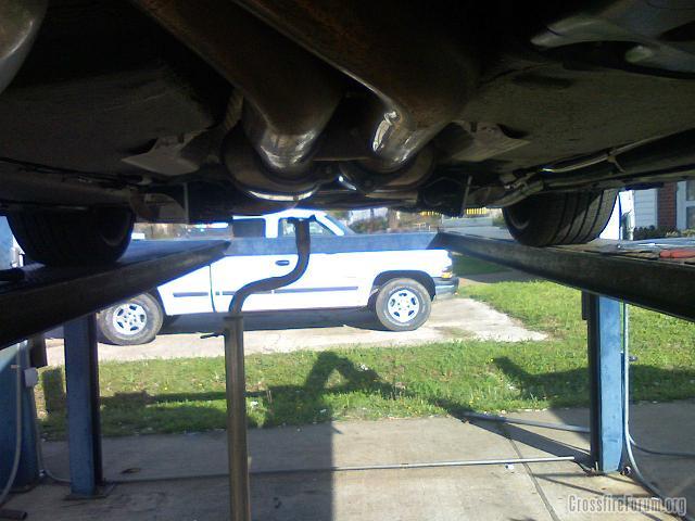

Install Side note: We had to remove the heat shields to gain enough ground clearance and since I didn't have any gaskets we ended up haveing to cut the pipe and reweld it. There was no way they could weld them in place, so the whole mid pipe had to come off. So have some gaskets or cut your pipes so you can drop them.

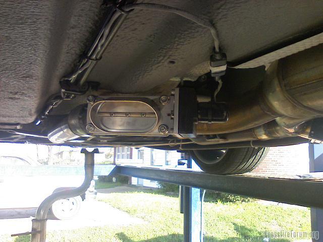

Got a couple pics of the install, the passenger side sits a little low due to clearance issues with the frame.

How well do the Cutouts seal when they are closed? I know they sometimes leak pretty bad and you can hear them.

Car sounds completely stock, no leaks detected these are supposed to be the best out there and have a 4 year warranty.
